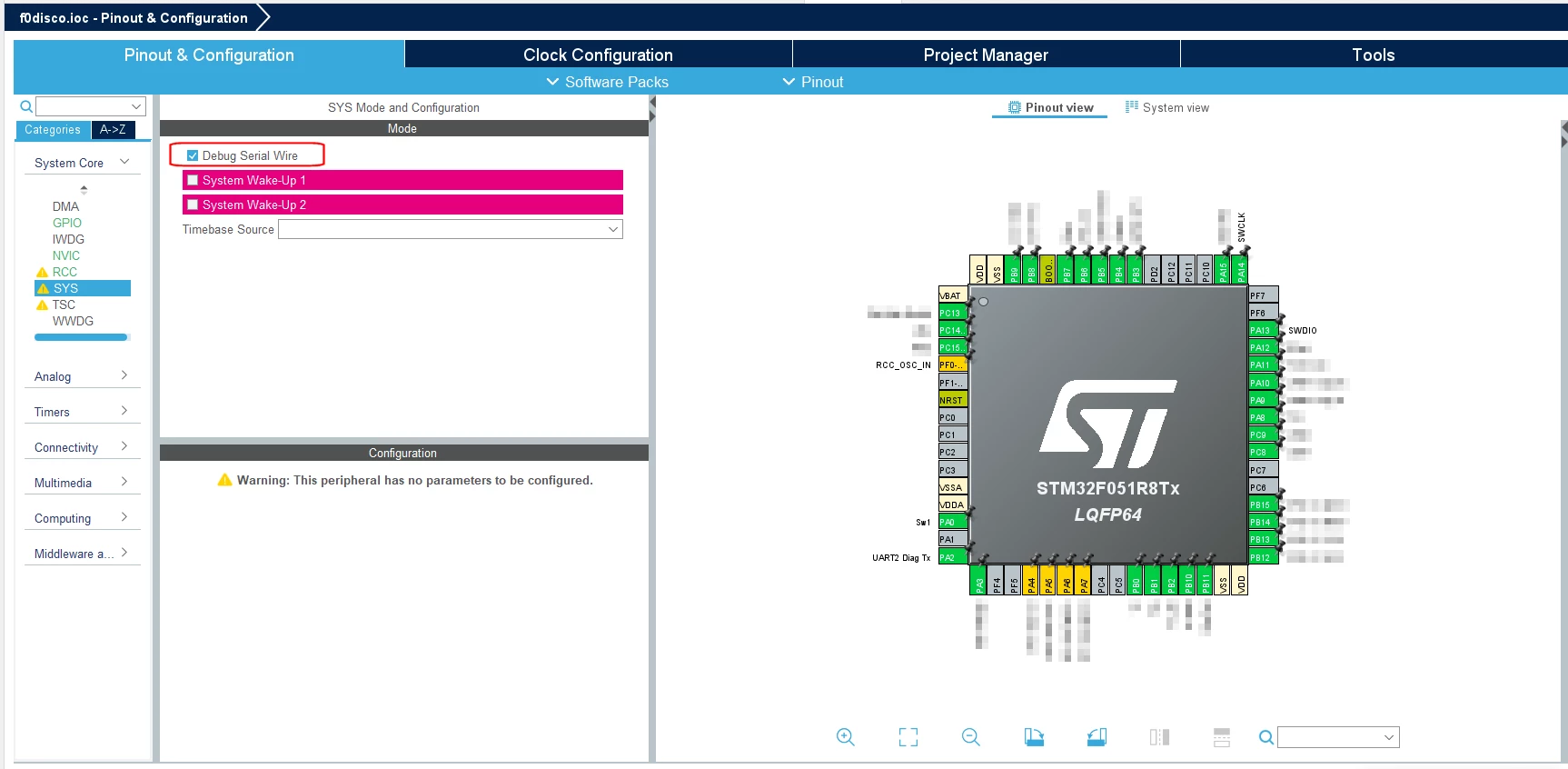

What is "Serial Wire" for under SYS
In STM32CubeIDE in the SYS tab there is a checkbox called "Serial Wire". When I check it, it highlights the two ports used for serial wire debugging. But that's all it seems to do. Is this just a helper to let me know where the debug pins are?

Yes basically SWD pins are marked in the Cube to let you know where are the debug pins (and avoid touching them in the program). The debugger configures them automatically.
> I don't see any SWO on this mcu so it can't have SWV right? This is Cortex M0+ I believe.
Yes. It is M0+ and it does not have SWO.
You mean in the Device Configuration view?
Here:
What IDE version are you using, and what chip?

Yes, thats the place. I have STM32G071. It doesn't have SWV. I thought it was for that at first. My IDE is 1.16.1
Oh yes, it does.
This is the debug interface, a reduced variant of JTAG.
The respective pins have SWD functionality by default after reset, you would need to reconfigure them at startup to change that.

But SWD works without this setting. And it doesn't seem to change the source at all. Does this enable attach while running or something?
