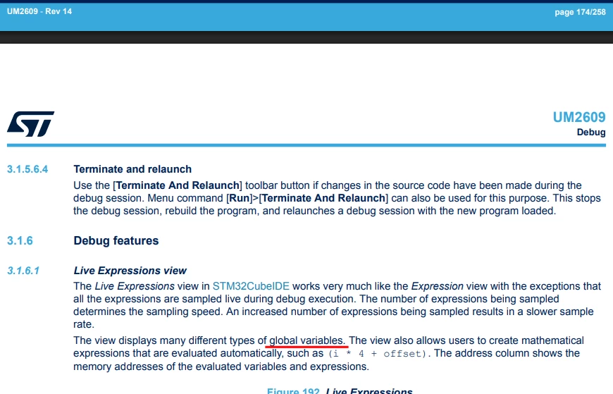

It does, indeed, say global variables:
https://www.st.com/resource/en/user_manual/um2609-stm32cubeide-user-guide-stmicroelectronics.pdf#page=175

That worked. Even class static doesn't work but full static variables do.
