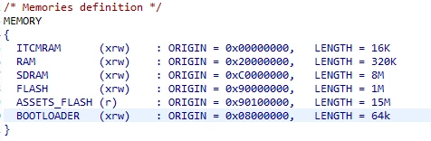

What is Command to Generate Binary for external flash. I want to add command in STM32CubeIDE Project->Properties->C/C++ build-> Settings->BuildStep->Post Build Step->Commnds:
We are Planning to Use STM32F7508-DK board for our Application. As I go through Datasheet of it. It is mention that 64 KB for internal flash. But I am very sure that my application required more than 64 KB.
PFA first

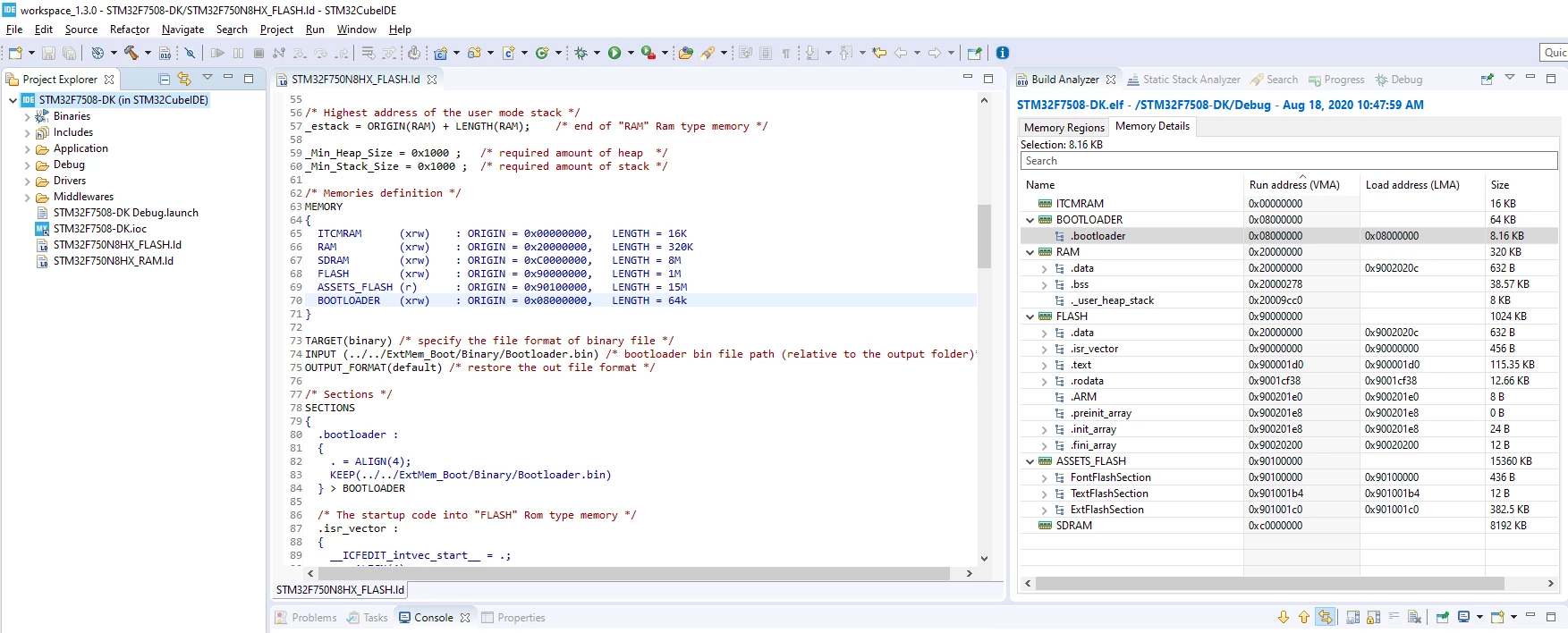

Question: As I can see my project is correct generated ?
Question: As I can see FLASH is 64 KB. why this is showing 1 Mb. Can anyone give me about all memory signifiance.
Question: I want to use external flash in case of my internal flash is full. So what exact change in my project ?
Question: What is command to generate binary for STM32F7508-DK board.
