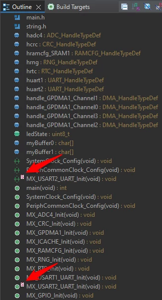

What does the red "S" in the CubeIDE Outline Window mean?
What does the red “S” in the CubeIDE outline window mean? Is there a description of the respective markers in CubeIDE somewhere?
Souhaib MAZHOUDBest answer
November 18, 2024
Hello @ledi7
The red S in the outline window indicates that the object is static.
You can find more details about these symbols in the menu -> Help -> Help Contents.
