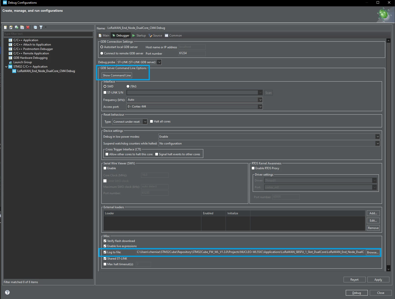

What command is used for flashing the MCU?
From the console of CubeIDE, I have seen that for compiling the command used is make -j9 all. I am wondering what is the command used for running a project given that I cannot see it from the console.

    Hello @ubaldot
    In the Debug Configuration>Debugger you can click on "Show Command Line" to see the debug command.
    Also you can enable the log as shown in the screenshot bellow.

    Ok, perhaps I should be more specific: I know that CubeProgrammer_CLI is invoked, but I would like to see exactly the whole command with all the flags, etc. :)

    Hello @ubaldot
