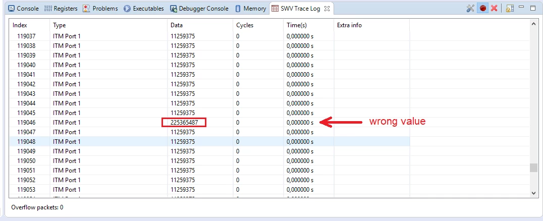

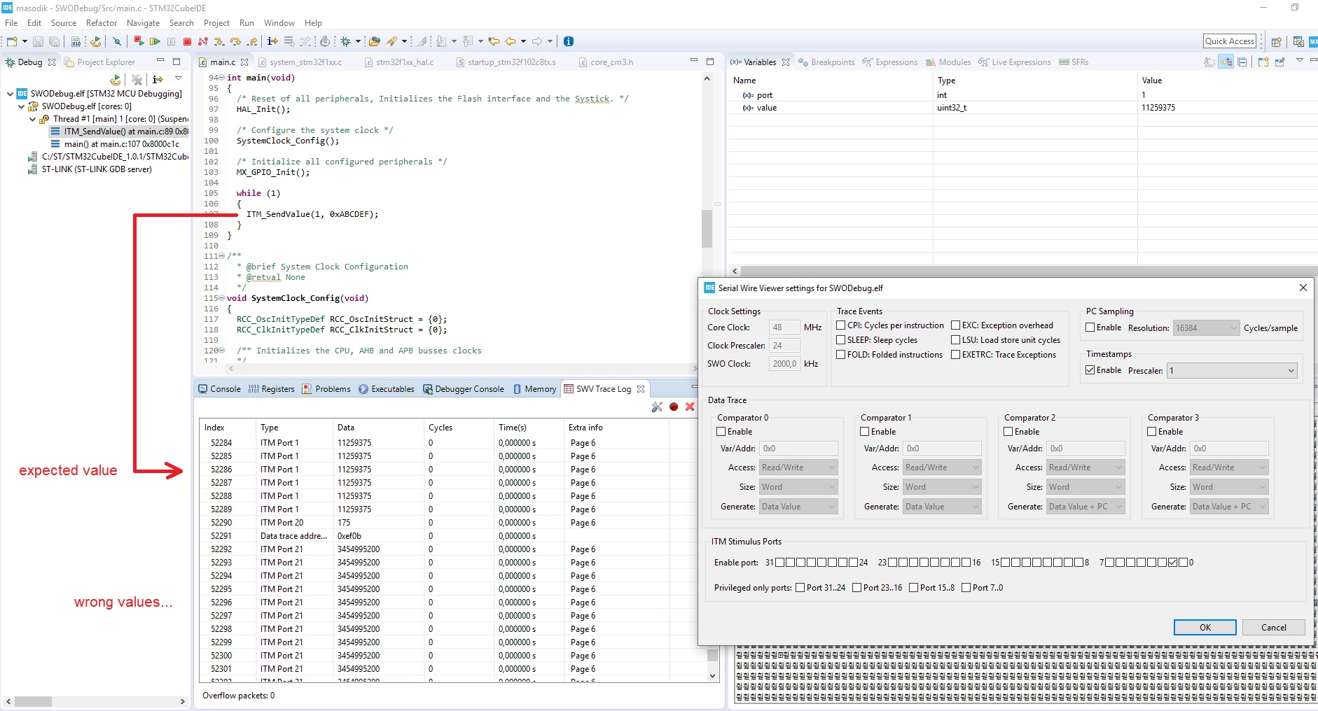

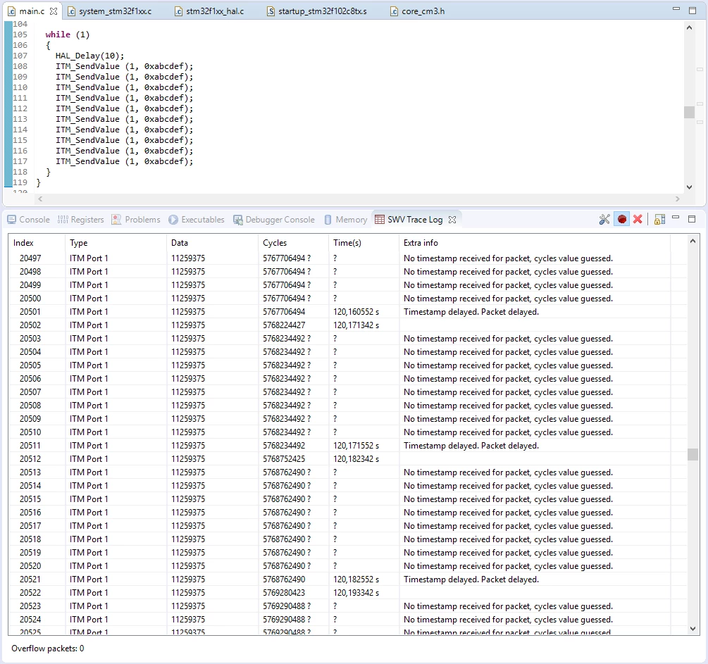

1. I tried to send a 32 bit value though ITMPort1 in an inifite
loop and it works awhile but sometimes it switches to ITMPort21 and
the value is different what I sent. After several hundred packets
it changes back to ITMPort1 and 0xABCDEF, which is the correct
value. I do not see any overflows. It the ITM sends the correct
values sometimes I see randomly wrong values.

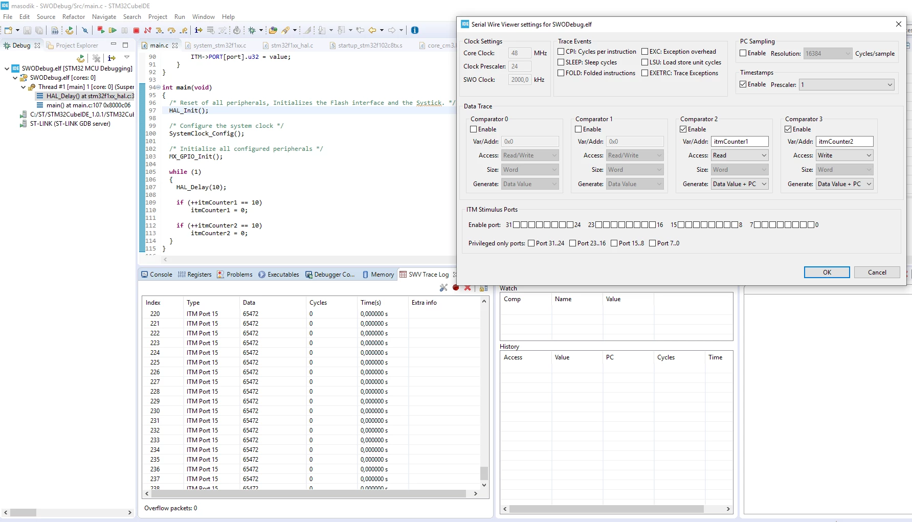

2. I tried the Data Trace function. If I ask both read and write
event for a variable it works well, but if I set only the read or
write event, I do not get the data trace events. The Trace Log
window is full of ITMPort15 packets (which is not enabled) and
the Data trace window is empty.
The itmCounter1 and itmCounter2 variables are declared as volatile,
and the optimization is switched off (-O0).
