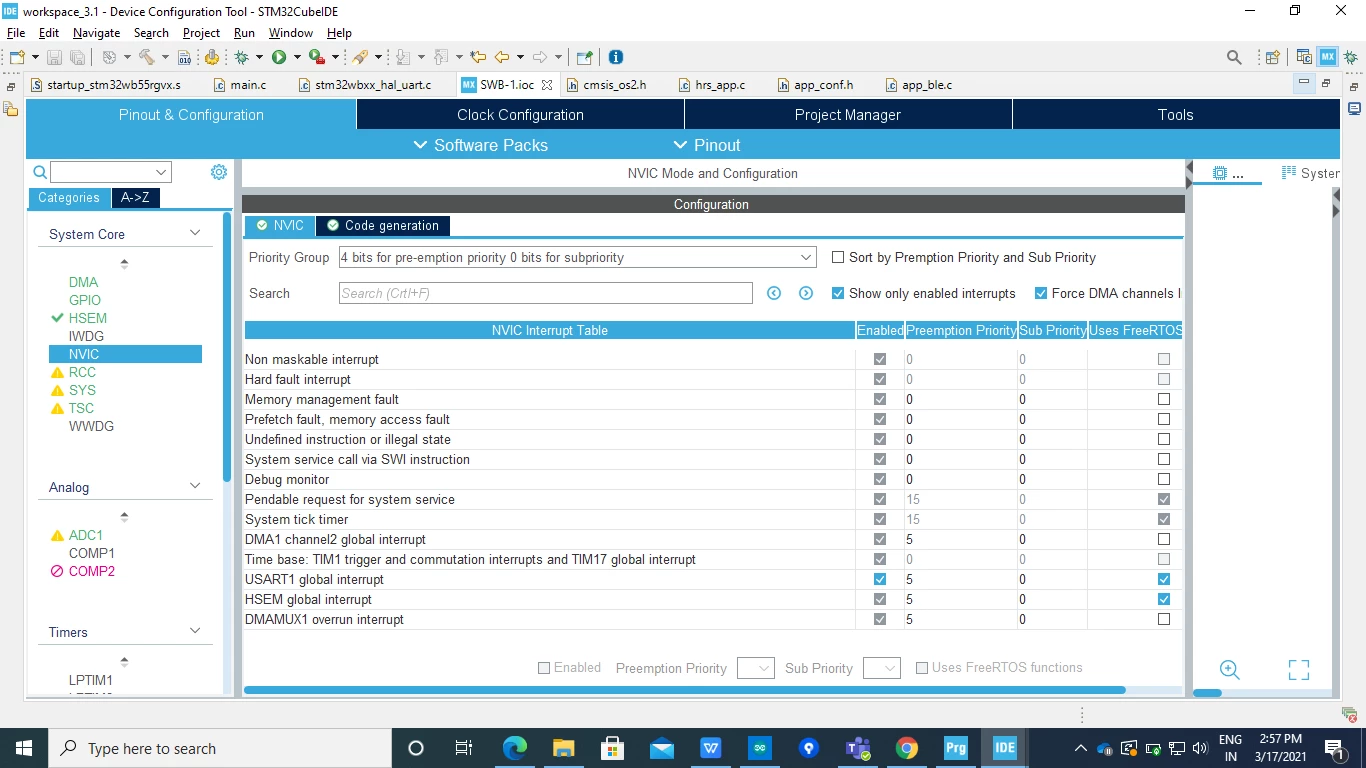

We Initialized BLE and FreeRTOS CMSIS_V2 from the .ioc configuration in the CubeIDE. But RTOS tasks are not executing.
I put breakpoints, but only up to following line
"configASSERT( ucCurrentPriority >= ucMaxSysCallPriority );"
in this function "vPortValidateInterruptPriority( void )" I was able to debug.

You gave a very brief error description. Looks like you are calling a FreeRTOS function from an interrupt handler of high priority. The max. allowed prio can be configured in FreeRTOS.

0693W000008x87yQAA.pngThanks for reply @KnarfB​  We just configured all peripherals, BLE, RTOS with single default task with priority of "osPriorityNormal" which is 24. We found three more RTOS tasks in auto generated code itself.
1. "HrsProcess()" which is in hrs_app.c with priority of "osPriorityNone" which is 0.
1. "HciUserEvtProcess()" which is in app_ble.c with priority of "osPriorityNone" which is 0.
1. "AdvUpdateProcess()" which is in app_ble.c with priority of "osPriorityNone" which is 0.
please find the image, I attached all active Interrupt's priorities.
