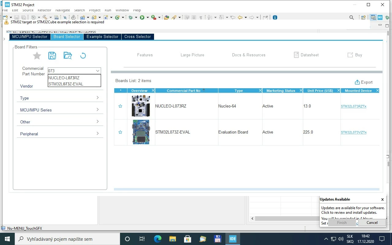

We are new to STM32Cube IDE. We are using Nucleo-L073RZ board. We need some example project for the same. Can anybody suggest how to get it?

Hello @Manan​ ,
Welcome to the STM32 Community :smiling_face_with_smiling_eyes:
I recommend you the ready to use examples with the STM32CubeL0 MCU package: STM32Cube_FW_L0_V1.11.3\Projects\NUCLEO-L073RZ\Examples
You will find a rich set of examples and applications for different toolchains (EWARM, MDK-ARM, SW4STM32) and select the one suitable for you.
Then, you can migrate the project to STM32CubeIDE following the user manual to import Cube projects from SW4STM32 to STM32CubeIDE:

MM..1
Dec 17, 2020 5:43 PM UTC
Or simply start new STM32 project wizard in CubeIDE and select

MM..1
Dec 17, 2020 6:23 PM UTC
After you do first project IDE downloads firmware and you can on my screenshot select too up Examples...
