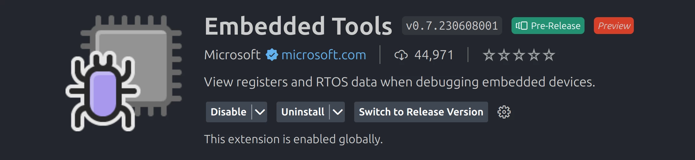

So add the setting for vs code
"vcpkg.diagnostics.additionalArguments": [ "--debug" ]
Lots of debug and it did fail. But I did notice it was looking in /home/iwiseman/.cache/vcpkg. Removing this and retrying still did not work but need I went to extensions for embedded and installed pre-release
_legacyfs_online_stmicro_images_0693W00000dDZzBQAW.pngIt did not work straight away but removing the vcpkg directory again and it did succeed.
I now have an .elf .bin and .hex file.
Next is uploading and debugging.
