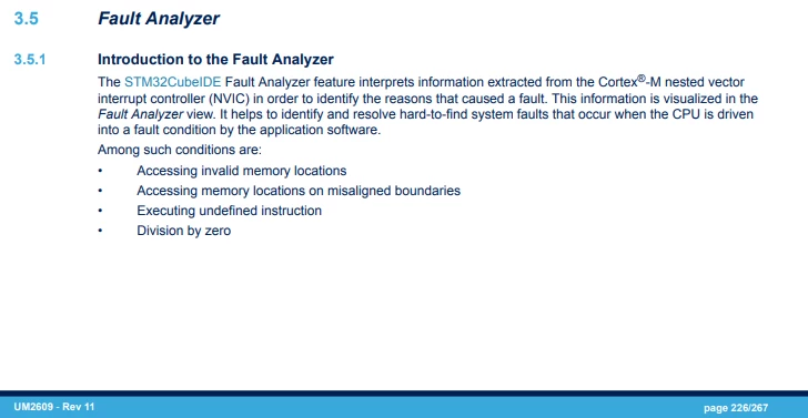

    The code looks OK. Debug as usual. HardFault where? The debugger of CubeIDE has convenient tool to analyze HardFaults.

    Some links here on debugging Cortex-M Hard Faults:
    https://community.arm.com/support-forums/f/embedded-forum/3257/debugging-a-cortex-m0-hard-fault
    See also CubeIDE Fault Analyser:
    https://www.st.com/resource/en/user_manual/um2609-stm32cubeide-user-guide-stmicroelectronics.pdf
