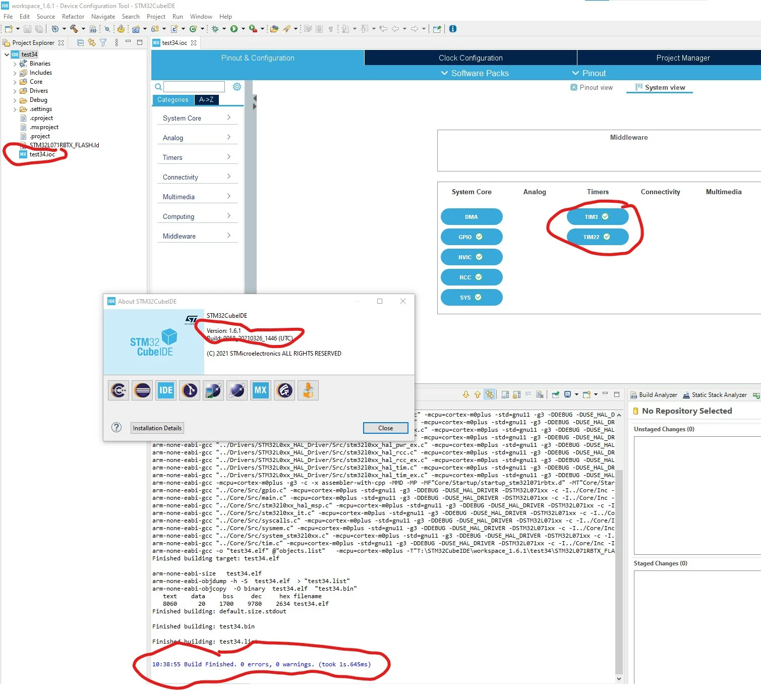

Cartu38 OpenDev
Graduate II
June 7, 2021
Works like a charm if 1.6.1 based on shared .ioc file.
@APavl.10​ which release are you relying on ... @Hampus Dunström​ post is quite old one (1.0.2 release based ...)

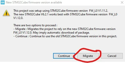

Based on promoted .ioc file I've selected migration path allowing to rely on most up to date material what's definitively solving trouble (able to reproduce initial issue if selecting 'Continue')
Mike_ST
June 7, 2021
It seems like there was a problem in 1.11.x, a TIM3 define was under USB switch:
stm32l0xx_hal_tim_ex.h:
#if defined(TIM3)
#if defined(USB)
#define TIM3_TI4_USB_NOE                 0x00000000U                              /*!< USB_NOE selected selected for PC9 (AF2) remapping */
#define TIM3_TI4_GPIOC9_AF2              TIM3_OR_TI4_RMP                          /*!< TIM3_CH4 selected for PC9 (AF2) remapping */
#endif /* USB */
In 1.12.0 it has been moved:
#if defined(TIM3)
#if defined(USB)
#endif /* USB */
