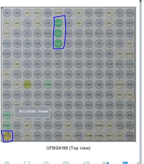

Using STM32CubeIDE in order to program SPI1 on STM32U585AII6Q with SW NSS. The relevant pins are not initialized and PinOut seems weird.
Trying to configure SPI1 with SW NSS on STM32U585AII6Q with STM32CubeIDE.
While generating the code, the relevant 4 pins are not initialized.
The PinOut looks like that. This grey shade seems suspicious to me.
Below, MX_SPI1_Init() and MX_GPIO_Init()

1 reply
Billy OWEN
February 17, 2023
Hi @bmn​
The forum moderator had marked your post as needing a little more investigation and direct support. An online support case has been created on your behalf, please stand by for just a moment and you will hear from us.
Regards,
Billy
