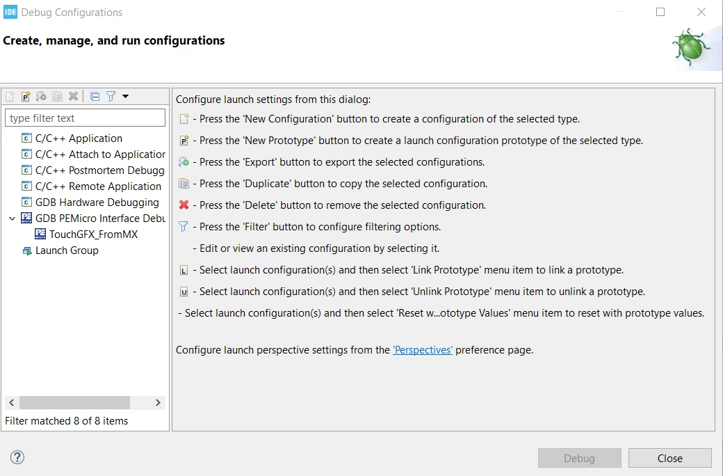

After the installation is complete the PE micro debug configuration is visilbe in debug config in STM32CubeIDE but ST link configuration is not visilbe which was visible earlier.
How do I add the ST link debug configuration now?
Please see attached debug config snapshot

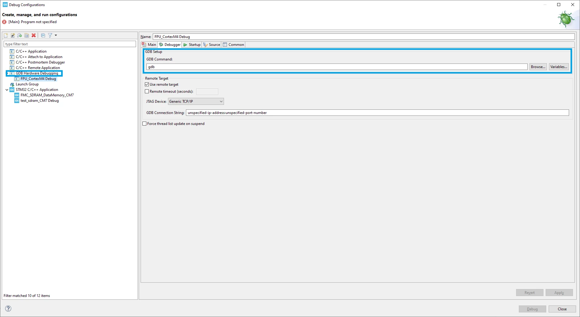

I can mention an other solution you can adopt: Go to debug configuration and select "GDB Hardware Debugging"
In this case you should set the debug command line manually.
