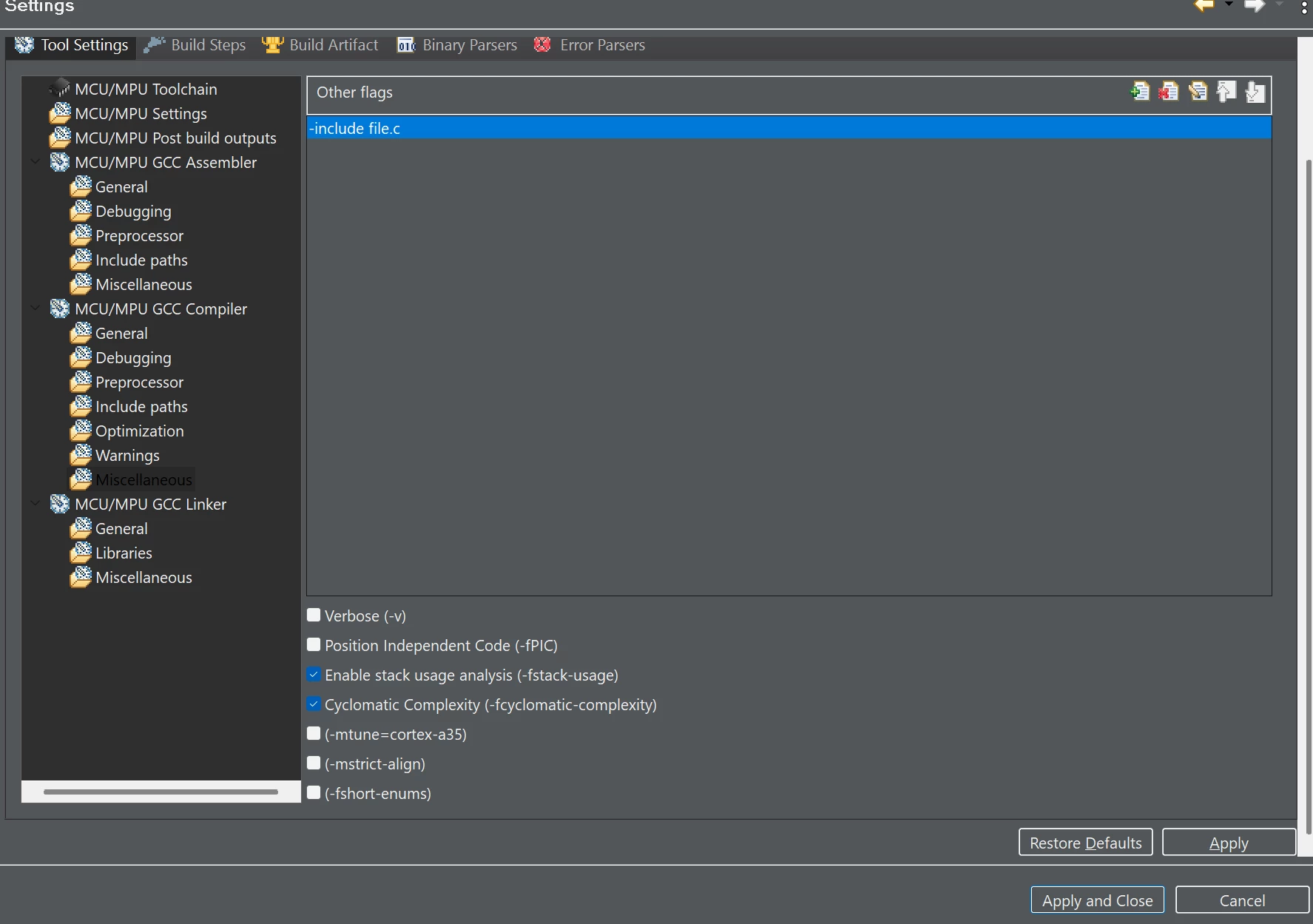

I have an STM32H743 project generated and i'd like to include an external file using the GCC "-include file" command option. I've added it as shown in this screenshot under C/C++ Build > settings > MCU/MPU GCC Compiler > Miscellaneous
The problem is the compiler doesn't seem to find file.c, no matter where I place it within the project directory. I've tried placing inside the same folder as main.c with no success.

The error:
<command-line>: fatal error: file.c: No such file or directory
compilation terminated.

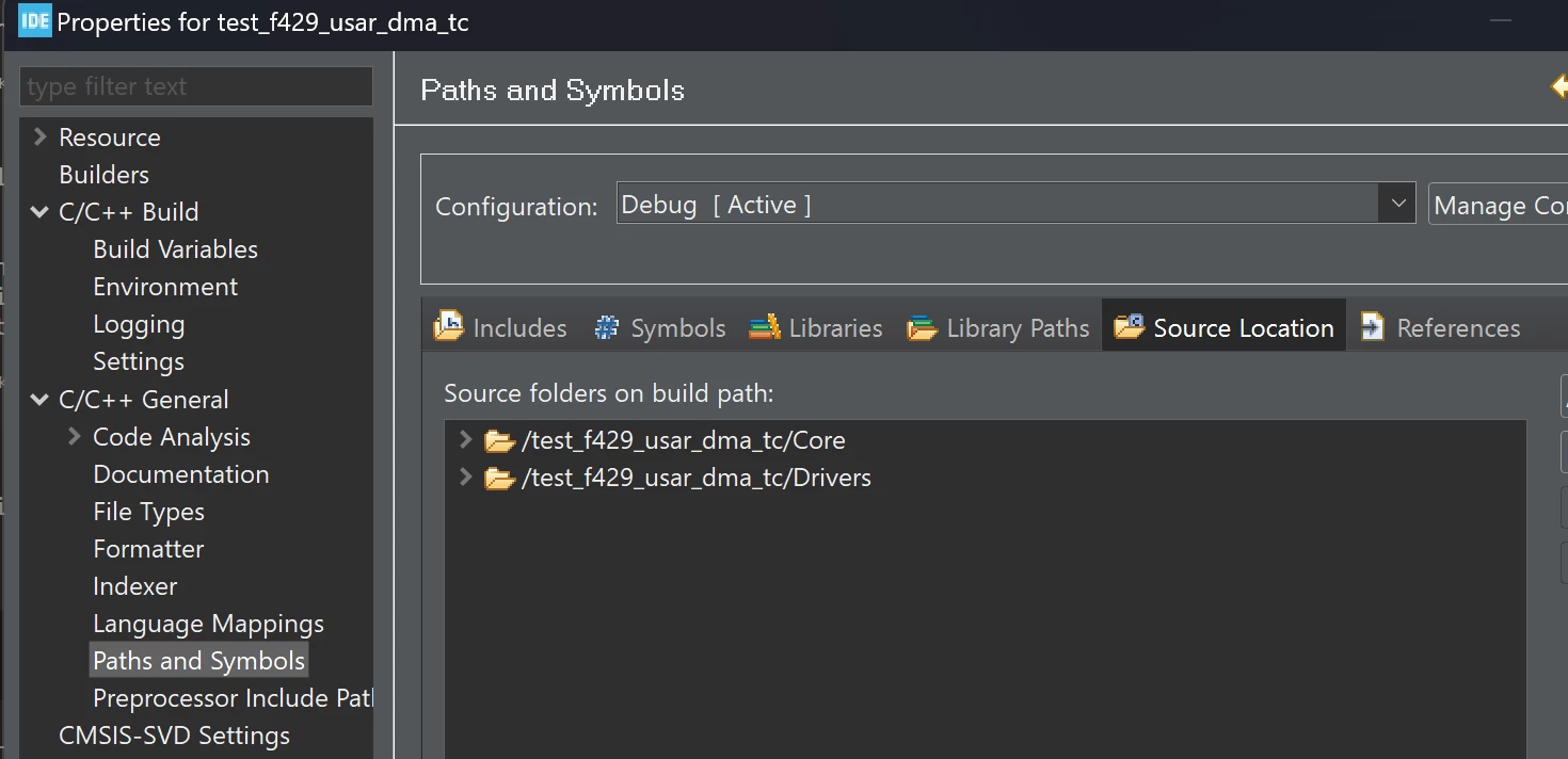

Update: I think i've figured out how to get it to know where the file is, by adding the path under C/C++ General > Paths and Symbols > Source Location. But I still have these make errors:

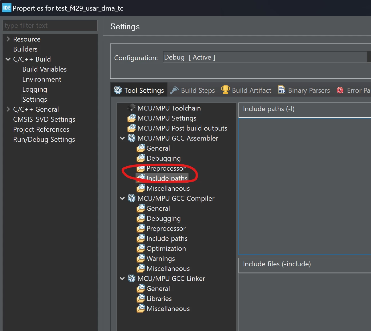

Source files (*.c) shouldn't be included. They are not within the include path if you are using an inc/src folder structure.
Include folders should be listed here for the various compilers. I should have circled the "GCC Compiler" one instead of assembly.
Source folders should be listed here:

What is the difference between a source folder and an include folder?
Tesla DeLorean
Guru
Jan 30, 2025 7:21 PM UTC
In the broader sense it is so stuff that's shared among multiple projects isn't duplicated into each. Say math, stdio and string libraries.
An Include Path provides an ordered list about where to search for them

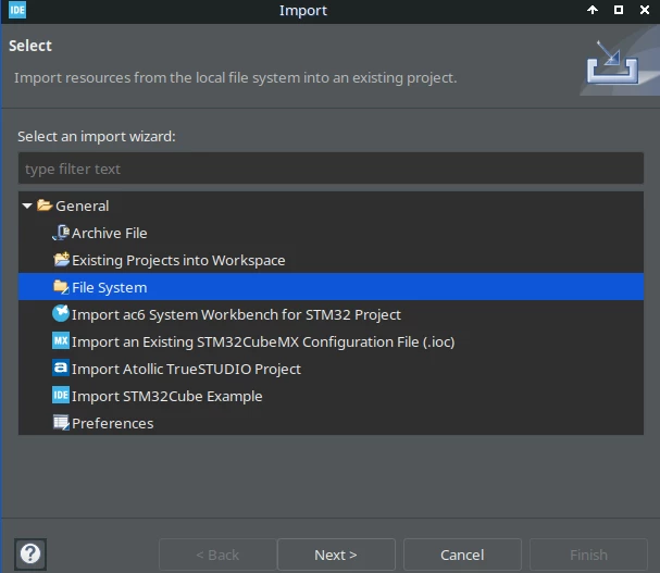

So you want just add a file to a project ?
Then IDE should know this :
open your project (left pane) and right click on the project name : select : import.
then you see:
then use > file system -> and set directory for import, then select .c or .h files and the folder, you want to have them.
Then IDE knows...if using include xx.h , what you want and will compile the c files imported also.
