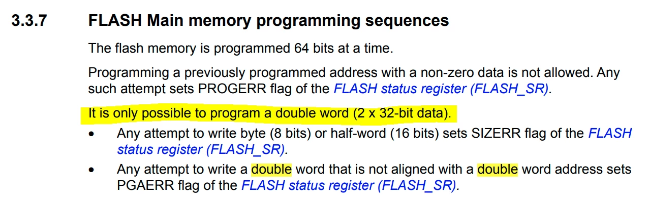

Good Day,
Is it possible to write a Word using HAL_FLASH_Program? If I use the TypeProgram =  FLASH_TYPEPROGRAM_DOUBLEWORD in the function (shown below) it will write to flash. If I use FLASH_TYPEPROGRAM_WORD it will not write to flash and I receive an error.
HAL_FLASH_Program(uint32_t TypeProgram, uint32_t Address, uint64_t Data);
Regards,
SJC
    TDKBest answer
    July 31, 2023
    Per the reference manual, the STM32C0 series can only program double-words in flash. Writes less than that will fail.

    Also there is no FLASH_TYPEPROGRAM_WORD defined in HAL:
    https://github.com/STMicroelectronics/STM32CubeC0/blob/8731fa98190b337c01e2a4c3d3a725fe6bf3c04a/Drivers/STM32C0xx_HAL_Driver/Inc/stm32c0xx_hal_flash.h#L224
    Therefore it's not even clear how the code is compiled in that case.
