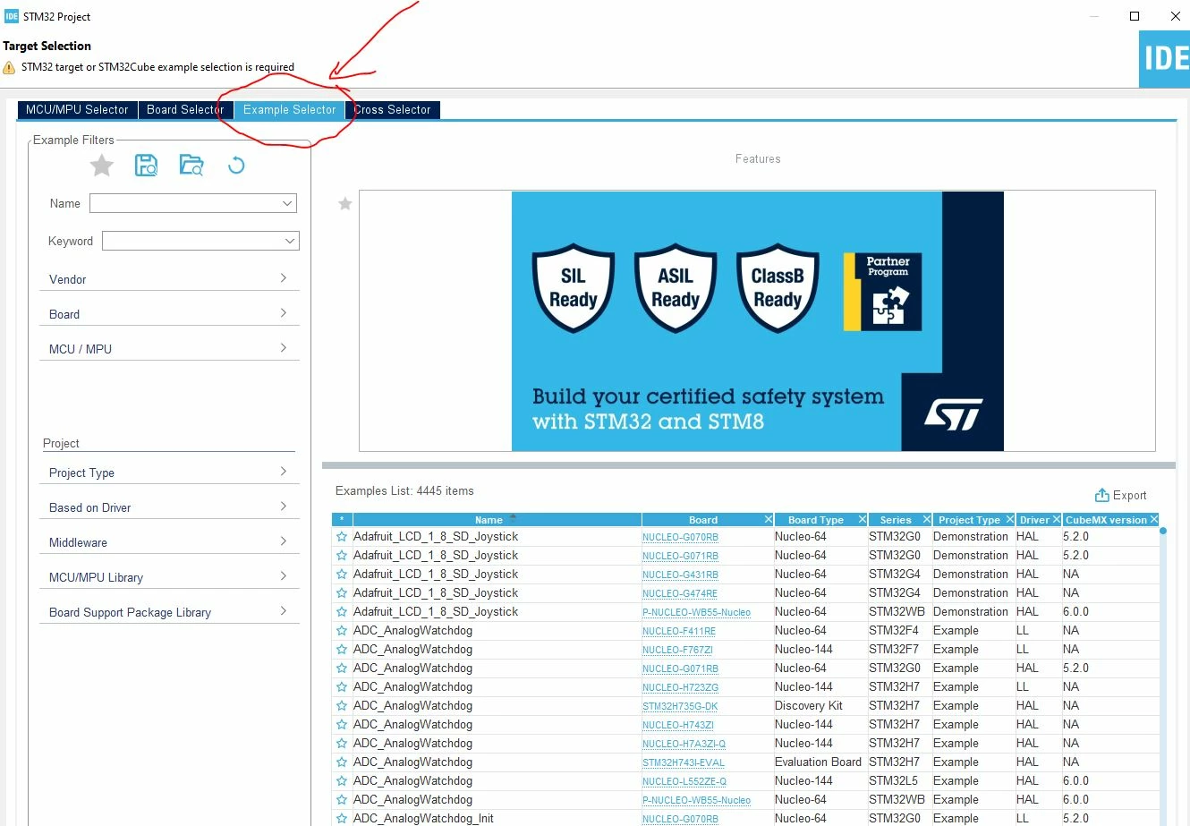

Fresh (releases done on wk31.1) STM32CubeIDE 1.4.0 & STM32CubeMX 6.0.0 are promoting some example import features !

Cartu38 OpenDev
Graduate II
July 30, 2020
Just get a look at target finder extra tab !
