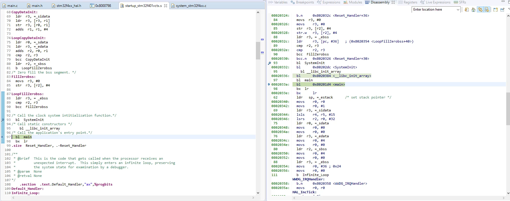

You are right, i noticed that if i set the function address via the second program start address (0x8020000) i go in the reset handler of the second firmware.
I tryed, debugging the second firmware, to detect the address of the main:0693W000003Ps4iQAC.png
So i set the address of the function (removing the "+ 4") to 0x080201D4, but when I call it from the first firmware i retreive an hard fault. I tryed the addresses from 0x080201C9 to 0x080201D9, but same result. What could be the problem?

Aug 20, 2020 12:54 PM UTC
Did you tried to set the address to 0x080201D5 instead.
PS. Maybe you get some more info by studying the STM32CubeIDE UM. It covers many aspects of linking and locating code at different places but it might not cover the way you try to use to fw in this way, The UM is available here:
