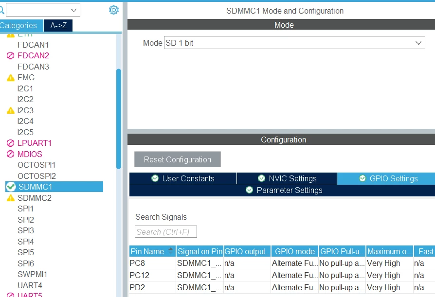

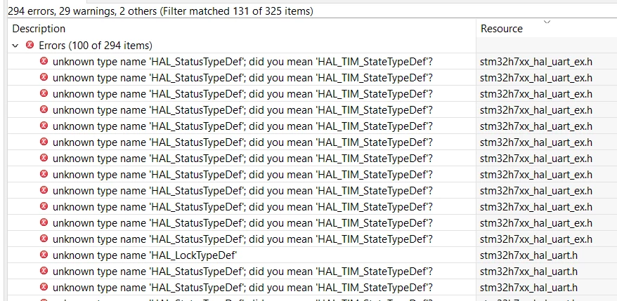

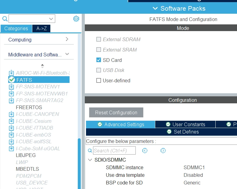

I am looking to write data in csv format to my SD card with an SD shield. So I activate the SDMMC1 port and the FATFS driver for my SDMMC1 port, when I generate I then have 300 errors on my HAL header. Do you have any idea what the problem is, and how to solve it, please? THANKS.

I found the cause of the problem but I don't understand it very well. Before configuring the IOC for my SD, I created two files: a header and a source to manage my recordings I called them SD.h and SD.c, deleting these files no more problems...

Could you please attach your ioc file?
April 16, 2024
Thanks for the help.
Attached the ioc file.

Thank you for the sharing,
I didn't reproduce the issue. Attached the project I've generated.
