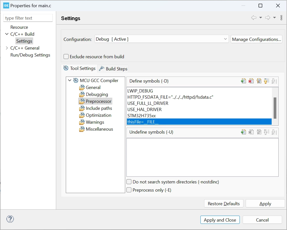

I want to automatically add the following line of code at the top of each source file within my project:
static char const thisFile[] = __FILE__;

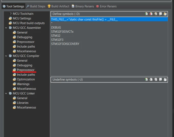

For this, I'm creating the following Define symbol (-D) in STM32CubeIDE, by going to project Properties -> C/C++ Build -> Settings -> Tool Settings -> MCU GCC Assembler -> Preprocessor:
However, when I click on OK -> Apply and Close, it shows this warning, which I don't completely understand.
Anyway, I click Rebuild Index, and it changes my symbol by removing the semicolon at the end and adding some new double quote symbol "
and, when I build the project after this (the code already uses thisFile string in its functions), it throws this error:
error: 'thisFile' undeclared (first use in this function)
I suspect, that it happens because the preprocessor can't properly transform the semicolon from my symbol, so the whole static char const thisFile[] = __FILE__ line becomes invalid.
Is there a way how to make this Define symbol (-D) feature to work with semicolons or maybe some other way how to add my desired line of code at the top of each source file?

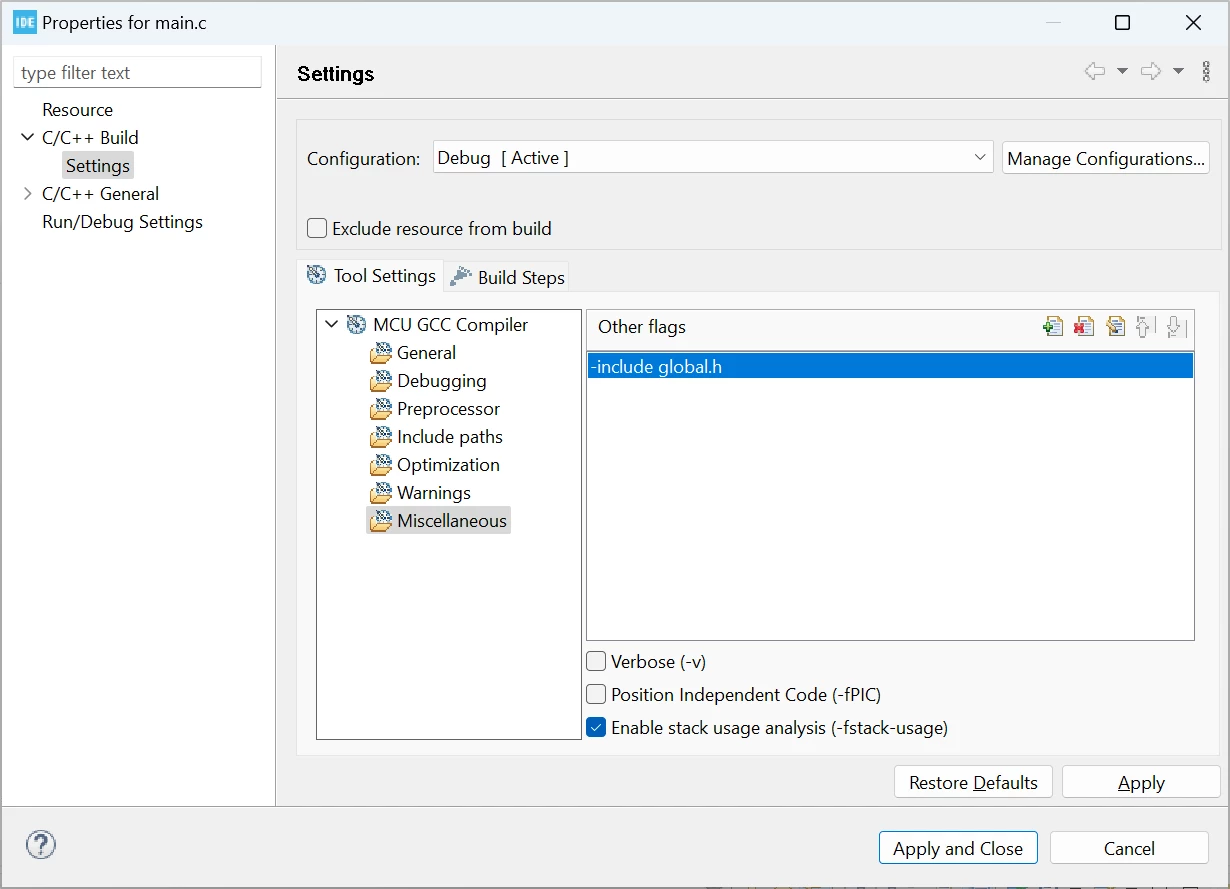

I've solved it.
Modify build command in STM32CubeIDE:
from:
${COMMAND} ${INPUTS} ${FLAGS} ${OUTPUT_FLAG} ${OUTPUT_PREFIX}${OUTPUT}
to:
${COMMAND} ${INPUTS} -D__CFILE__='${INPUTS}' ${FLAGS} ${OUTPUT_FLAG} ${OUTPUT_PREFIX}${OUTPUT}
for the equivalent of __FILE__
or even better:
${COMMAND} ${INPUTS} -D__CFILE__='"${InputFileName}"' ${FLAGS} ${OUTPUT_FLAG} ${OUTPUT_PREFIX}${OUTPUT}
for the equivalent of __FILE_NAME__
or
${COMMAND} ${INPUTS} -D__CFILE__='"${InputFileBaseName}"' ${FLAGS} ${OUTPUT_FLAG} ${OUTPUT_PREFIX}${OUTPUT}
for the equivalent of __BASE_FILE__
Inside a header file the macro __CFILE__ will have not expand to the path of the header file being processed, but to the path to the C file that includes the header file.
Combine this with with -include global.h in misc and with global.h containing:
static char thisFile[] = __CFILE__;
Now it works. This does not work with __FILE__ or __FILE_NAME__ as those will expand to the path or name of the header file.
you are creating a #define for the "MCU GCC Assembler". do it in the "MCU GCC compiler" section instead.
April 26, 2024
Ok, I've added the same symbol there, but the result is the same
Guillaume K
April 26, 2024
Is there an error reported by compiler ?
I suggest to remove the double quotes. Especially the double quote that is on the second line.
In your C code, how do you use THIS_FILE__ ? I suggest to add a semi colon after THIS_FILE__ on a single line:
THIS_FILE__;
Try to find in the CDT build console what command line is really used ( "arm-none-eabi-gcc c:/path/to/file.c -DTHIS_FILE=...")

That's not how define works. A define creates a symbol that can be used for text substitution or conditional compilation. It's not designed to add code to a file. That's what include is for.
You can define the symbol like this:
The index keeps track of all the symbols in the code, so you can navigate to declarations and definitions of variables and functions. If you change global symbols all files have to be recompiled and this potentially affects the index.
I have a better solution. Use the -include command to force include a file in all source files without modifying the files. You will need to create one header file.
global.h:
