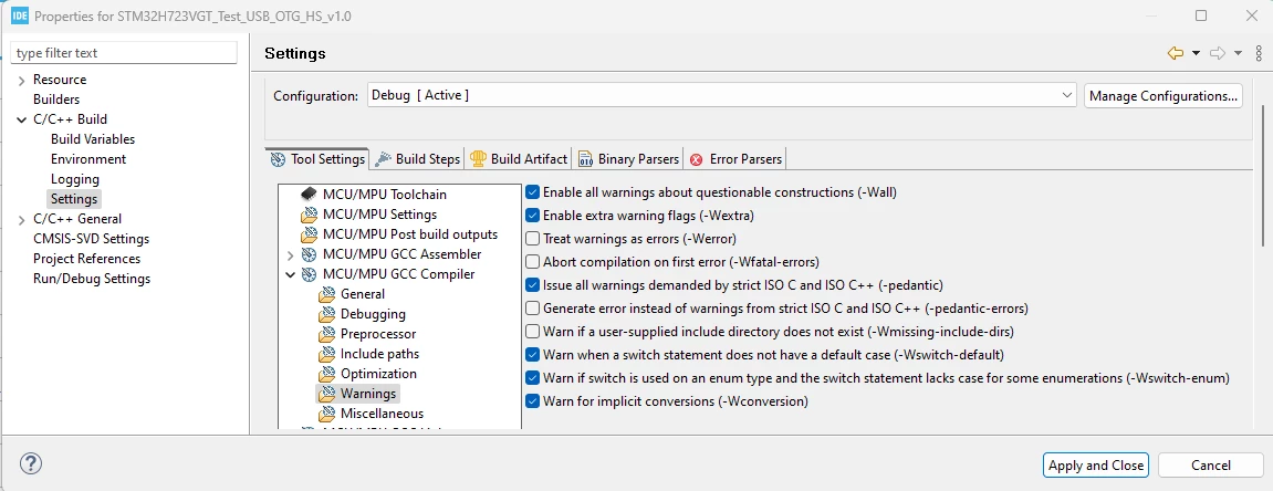

In another attempt to find a clue, I changed the compiler preferences to show all possible errors and warnings, see picture below:
Building the project with this configuration resulted in a shocking list of warnings, many signaling casting issues. Checking on the files involved, I detected a function with useless content, see below:

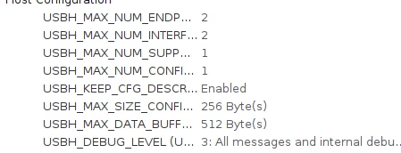

+ did you enable the built in debug messages ? Maybe its helping...
in Cube : USB settings ->
9 replies

Warnings: newer GCC compiler versions produce more warnings and they are enabled by default. Since this is not your code and you have no clue why the warnings, just disable them for now (but note for later).

I was not aware of the possibility to modify the Debug level for USB in the configuration window of an USB -Device. I certainly will keep it in mind. And I learned it is not possible to debug an USB connection problem because of strict timing requirements, very helpful to know. Triggered by the two recent reponses on my help request, I tried once more to get USB_OTG running on my WeAct H723VG board.
