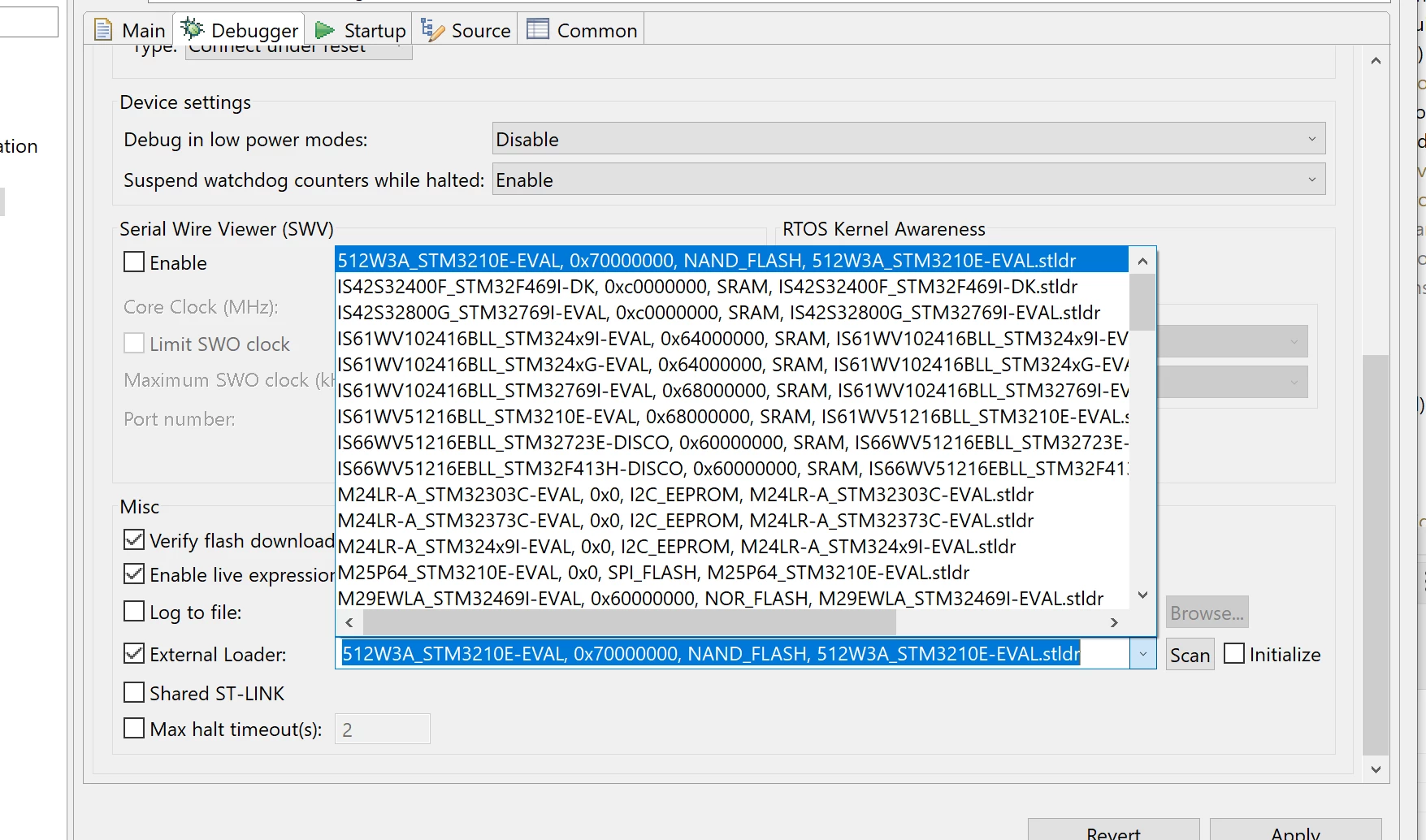

I want load a image into external flash memory [QSPI]. Is there any easy way to do it?

In IDE choice one external loader right for you in running config
simmilar in PRG. But for custom boards and flash you must write own stldr based on docu...

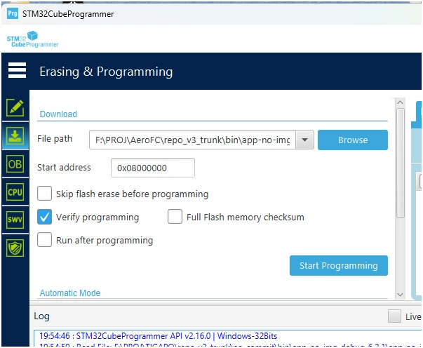

The easy and natural way to load .bin files is using CubeProgrammer (or its command line version). CubeIDE (the debugger) supports elf and hex files, so you'll have to convert your bin to hex. Not a big deal, but why?

@Pavel A. How to do it in CubeProgrammer. I tried but I can't flash the .BIN into my external flash memory. Can you please help me to solve the task?

Sure! No video needed, it is super simple. Just open the Programmer, connect to the board.
Then select Erasing and programming. Browse for the .bin file and enter the start address. and other options as needed.
Good luck.
