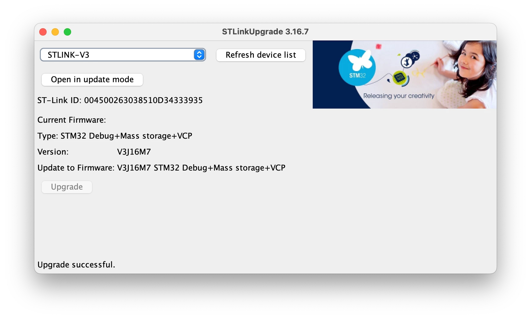

Reinstalling the ST-Link Server ended up solving the problem, but it was not as straight forward as I thought it was going to be.
Installing it went smooth and quiet.  Restarted STM32CubeIDE, then I was a little surprised by running the project.  I just expected it to work, but I was presented with a "firmware version mismatch" dialog.  It said the firmware on the ST-Link hardware on the evaluation board was older than what the IDE expected.
So at this point, I was relieved.  I think the advice from @FilipKremen  was correct, but they could have explained the following:
1. Reinstall the ST-Link Server, this will make STM32CubeIDE check the ST-Link firmware
2. When using ST-Link within STM32CubeIDE the next time, a firmware check will indicate the firmware is the wrong version.  Proceed with the firmware update.  Accept all default settings.
This is the upgrade window upon completion of my ST-Link firmware upgrade.
The ST-link now works a it used to work prior to the STM32CubeIDE update.  Thanks so much!
