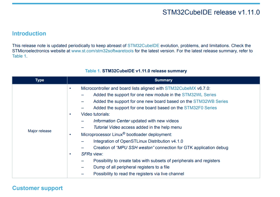

I have installed STM32CubeIDE generic v1.11.0. I have STM32CubeMX with version 6.8.0 installed by default with IDE. The same is mentioned in the release note as well.
When I want to upgrade the STM32CubeMX from 6.7.0 to 6.8.1 within the same STM32cubeIDE v1.11.0. Is there a way I can do that? Can anyone please share their thoughts? Since this is very time-critical it would be very helpful if anyone could look into this ASAP.

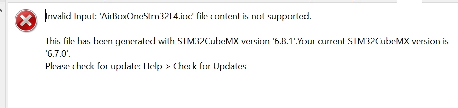

Thank you for looking into it. Since the requirement of my project is to use a specific version of IDE (e.g. v1.11.0). I didn't go for upgrading the same. When I open the .ioc file created on this version, it shows me the below error.
Does that mean by using the same v1.11.0 I need to upgrade STM32CubeMX to 6.8.1? Or do I need to use the IDE version which has the STM32cubeMX with the 6.8.1 version?

You cannot update the CubeMX installation within CubeIDE without updating CubeIDE itself. The two are linked for any particular version.
You can install the standalone STM32CubeMX program and choose whichever version you want.

Yes, you need an STM32CubeIDE version that has STM32CubeMX v6.8.1 or higher to open it.
If this is the requirement, your current IOC file is unacceptable since it won't work in that version of IDE.

Thank you for the clarification. I got it now. I have updated the STM32CubeIDE version to updated one and I'm able to resolve the issue.
