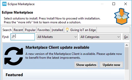

Updating software has encounters a problem: I tried a few thing seen on eclipse sites but nothing works. Someone have an idea? Thanks.
An error occurred while collecting items to be installed
session context was:(profile=STM32CubeIDE, phase=org.eclipse.equinox.internal.p2.engine.phases.Collect, operand=, action=).
No repository found containing: osgi.bundle,org.eclipse.epp.mpc.core,1.8.2.v20200210-1402
No repository found containing: osgi.bundle,org.eclipse.epp.mpc.core.win32,1.8.2.v20200210-1402
No repository found containing: osgi.bundle,org.eclipse.epp.mpc.help.ui,1.8.2.v20200210-1402
No repository found containing: osgi.bundle,org.eclipse.epp.mpc.ui,1.8.2.v20200309-0038
No repository found containing: osgi.bundle,org.eclipse.epp.mpc.ui.css,1.8.2.v20200210-1402
No repository found containing: org.eclipse.update.feature,org.eclipse.epp.mpc,1.8.2.v20200309-0038

Did you tried to update the Marketplace Client regardless STM32CubeIDE?
If an update is available a notification should be displayed on top of the client:
This is another way to solve the trouble, at least it worked well from there.
