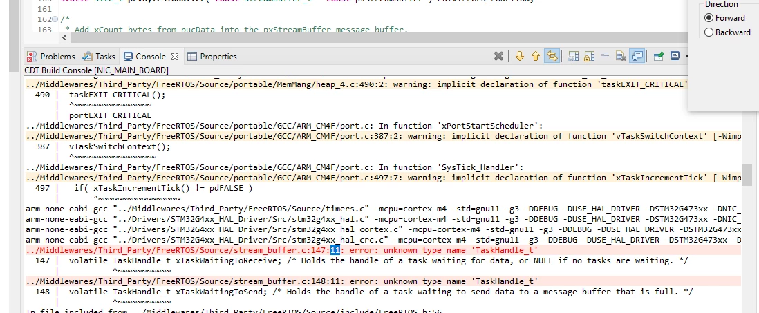

Updated my tools to STM cube IDE Version: 1.8.0 , and now none of my older projects are able to build without errors .

I seem to get only RTOS errors and warnings.
How to solve this easily ? or do i just install the older version back?

seems to be a problem in a library i included ... no issues are caused by STM or RTOS

even when i install older STM32cubeIDE , the free rtos errors stays ...
someone have the same problems?

Missing include path in the compiler settings ?

I did not change the project, which was compiling fine.
Just checked if the headers of RTOS are still included in the project, this seems fine ...
