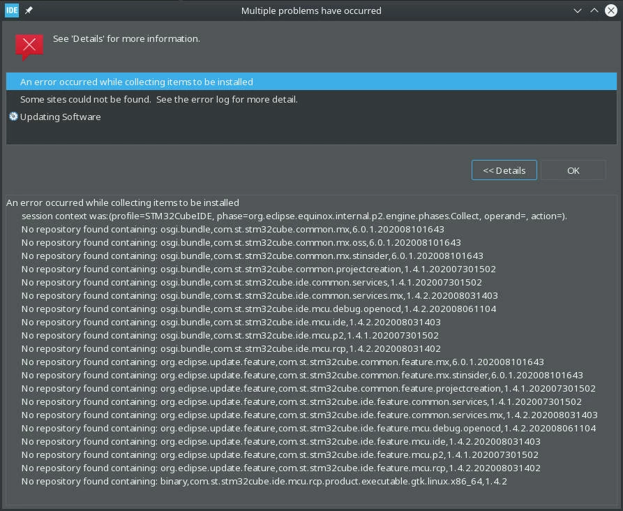

Update problems, ful install 1.4.0 update to 1.4.2 problems
Computer in Linux.
I already have stcubemx 6.0.1 installed
I install the st-stm32cubeide_1.4.0_7511_20200720_0928_amd64.sh, installation OK.
The program indicates that there is version 1.4.2, I start the software update and it gives me the following errors:0693W000005A6s4QAC.jpgHow can I solve the problem and upgrade to version 1.4.2?

Julien D
Nov 3, 2020 7:33 AM UTC
Hello JPita,
Thanks for reporting, there was an issue with the repository.
It should be fixed right now.
Could you reload every checked repository sites from Preferences > Install/Update > Available Software Sites and try to update again?
Paste there any error which might occurs during the refresh.

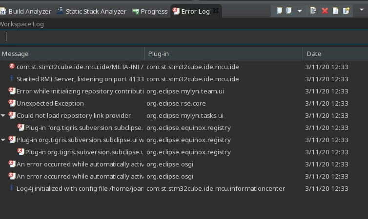

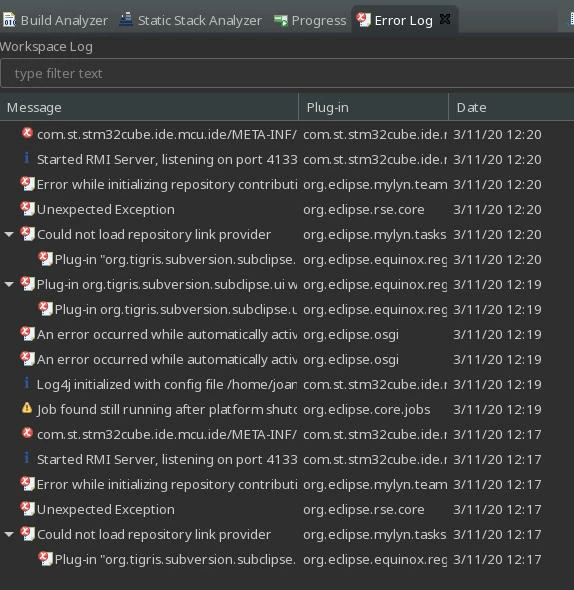

JPita
JPitaAuthor
Nov 3, 2020 11:32 AM UTC
Thanks, if I have been successful in the update, I now have version 1.4.2.
I still have the following errors:
0693W000005ABFqQAO.jpgSome are from Eclipse but there are also from st, how can it be fixed?

Julien DBest answer
Nov 6, 2020 5:31 PM UTC
This view displays cumulative logs among all your STM32CubeIDE sessions. This is the representation in GUI of the .log file located in your workspace metadata.
It is useful to understand and debug problems, but like kernel logs, a single error does not necessary means that your entire STM32CubeIDE is corrupted.
For example here the only com.st error log entry is well known and has clearly no impact on any features.
I simply suggest you to close the view and ignore it if everything is fine. If you need a specific answer please share the .log file with your question.
JPita
JPitaAuthor
Nov 8, 2020 10:29 AM UTC
Thank you, the stm32cubeide works correctly, I will follow your suggestion.
