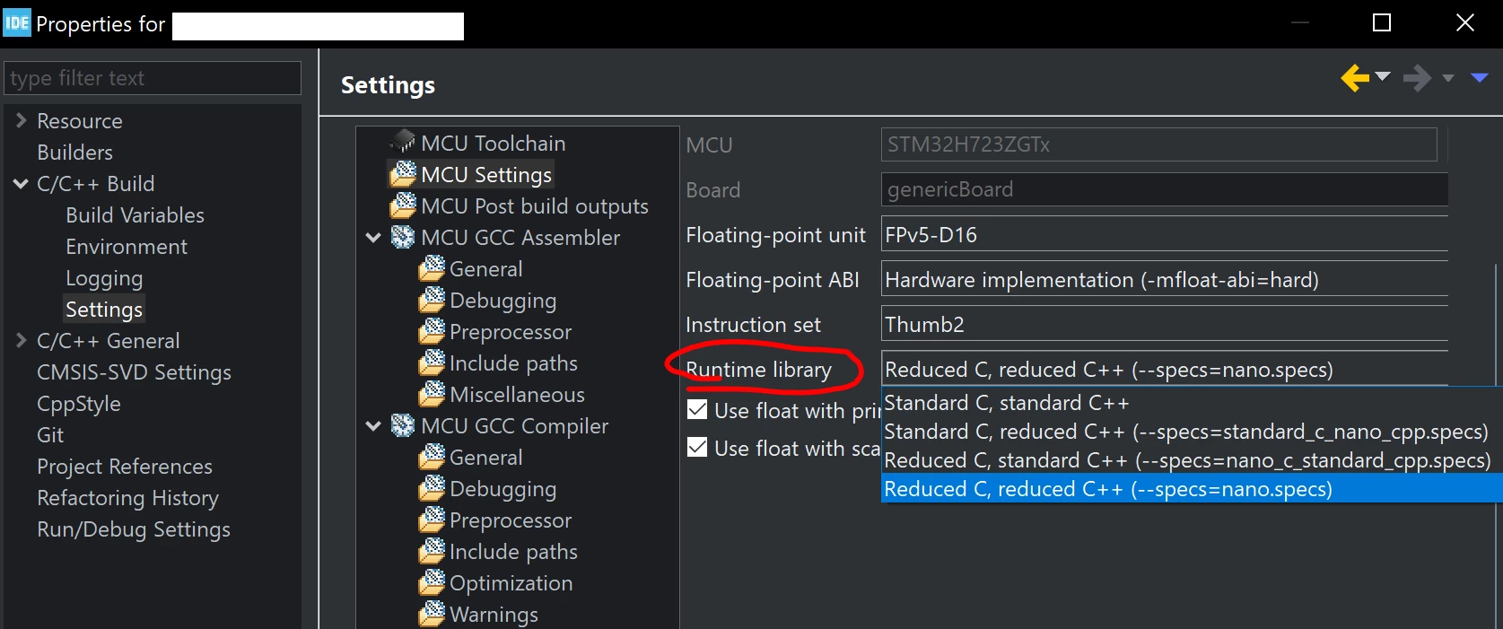

I am using the STM32H745 series MCU, with the latest (or very recent, at least) version of CUBE IDE.
I'm having difficulty getting past errors for including CDT list, map etc
IE #include <list> ... doesn't include C++ CDT list and results in errors
Are there any compiler settings, to force inclusion of the full C++ CDT?
Or any middleware/ 3rd party STM32 forks, that I can use?

In project settings -> MCU settings, you can choose the C++ library.
Although <list> compiles fine for me with nano, so not sure what would be different.

Reduced C, standard C++ switch, seems to have taken 190 'unfixable' errors down to 35 'fixable' ones
