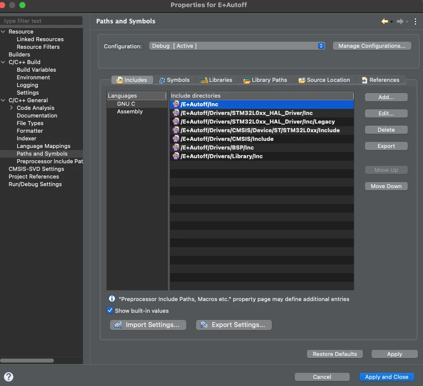

3.add library path to
"Properties -> C/C++ General -> Paths and Symbols -> Includes ->GNU C"​

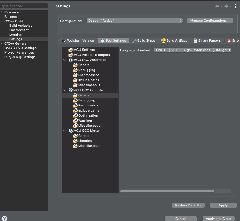

​0693W000006FYZTQA4.png​and follow this article i check my project ids using GNU11
​https://community.st.com/s/question/0D50X00009Xka2a/weak-clang
​0693W000006FYZYQA4.png​but I got the error message after Building project
../Drivers/Library/Src/button.c:232:1: error: unknown type name '__weak'
../Drivers/Library/Src/button.c:232:17: error: expected '=', ',', ';', 'asm' or '__attribute__' before 'BTN_now'
make: *** [Drivers/Library/Src/subdir.mk:24: Drivers/Library/Src/button.o] Error 1
make: *** Waiting for unfinished jobs....
can some help me that , thanks

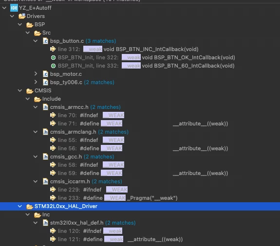

I finally fine the define of weak function in STM32L0xx_HAL_Driver​
 0693W000006FemTQAS.pngand after define  __attribute__((weak)) , this problem was solved

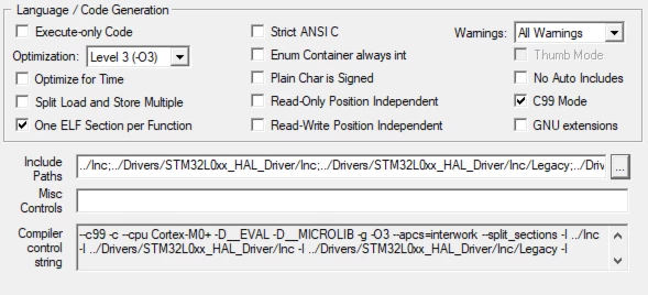

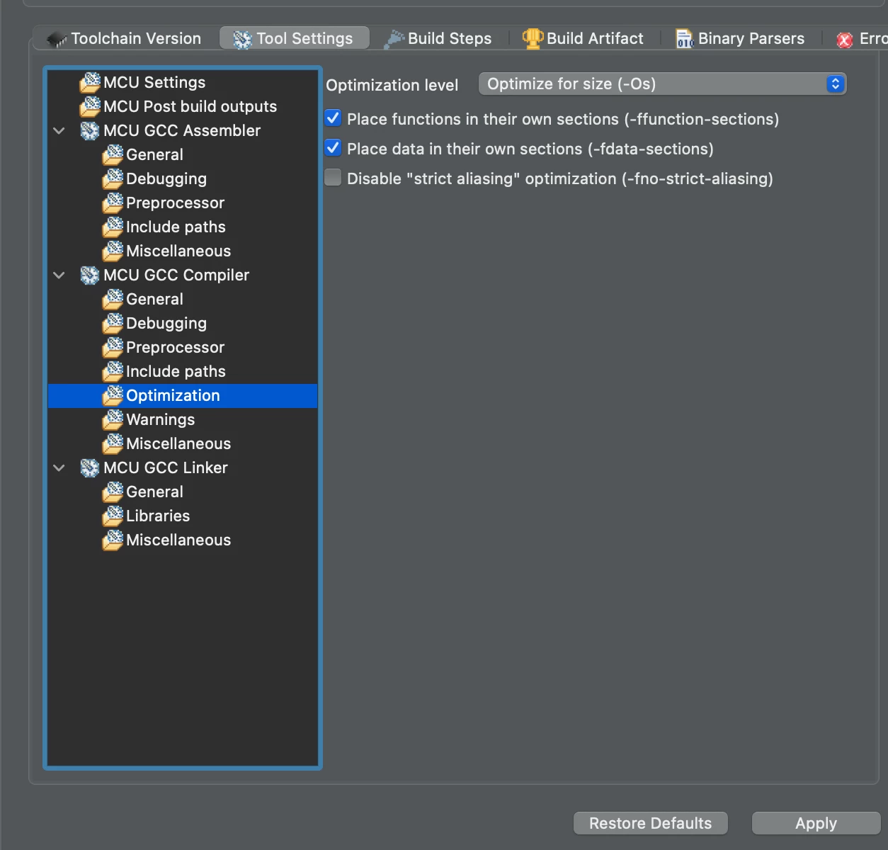

I find another interesting problem about code size,
same project between KEIL and STMcudeIDE have huge different code size
I try solve this problem by this article
If i solve it , I will tell you that ​
​B.R.
In Cube ide
0693W000006Feq6QAC.png 0693W000006FeuSQAS.png​
In Keil
0693W000006FetjQAC.png0693W000006FetoQAC.png​
