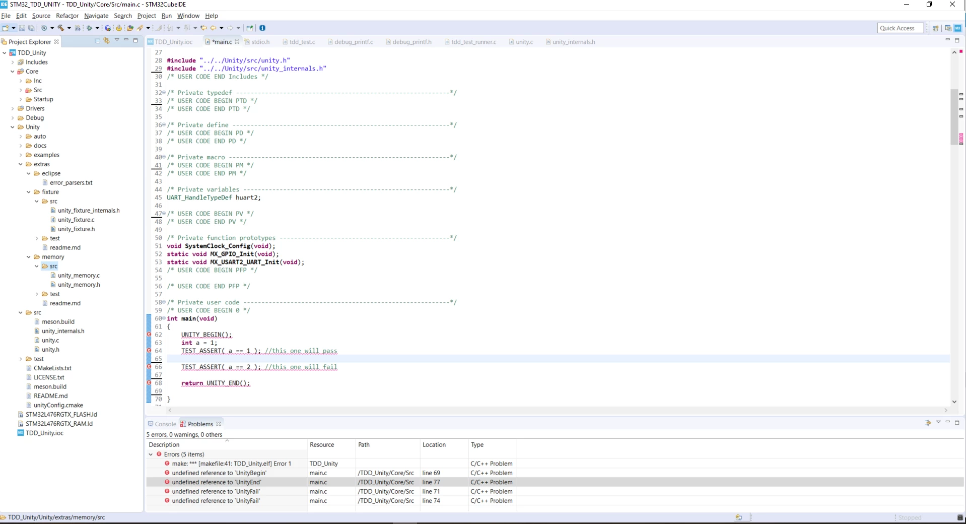

Thanks for your response. Sorry i couldn't understand "console prints" exactly. Did you mention "UnityPrint" functions? Is there a #define for disable all console print functions?
And when i add simple code i get this errors >> undefined reference to 'UnityBegin' , undefined reference to 'UnityEnd' ... . I added screenshot too.
#include "../../Unity/src/unity.h"
#include "../../Unity/src/unity_internals.h"
/* USER CODE END Includes */
int main(void)
  UNITY_BEGIN();
  int a = 1;
  TEST_ASSERT( a == 1 ); //this one will pass
  TEST_ASSERT( a == 2 ); //this one will fail
  return UNITY_END();
