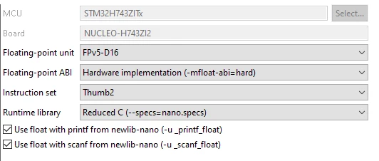

I want to use the intrinsic floating point absolute value function `__fabs` as noted in the compiler specific features in the armcc documentation.
When I build my project using the following settings on STM32CubeIDE:
I get an error saying undefined reference to `__fabs`; when I switch Toolchains to MDK-ARM the project compiles fine with `__fabs`. Are there some settings to enable intrinsic on STM32CubeIDE?
But the compiler of CubeIDE is not armcc. It is gcc.

This may not be the solution you were looking for; however, I was left with some constraints;
  1. I did not want to include the entire math header.
  2. This had to compile for STM32CubeIDE, MDK-ARM, and a linux version.
My goal for the following code snippet was to use the standard math libraries `fabs` function if the intrinsic function was not defined.
// declare math fabs
double fabs(double);
// declare instrinsic __fabs for armcc
double __fabs(double value) __attribute__((weak));
double __fabs(double value) {
 // use math libraries if not found
 return fabs(value);
static inline double floatAbs(double value) {
 return __fabs(value);
