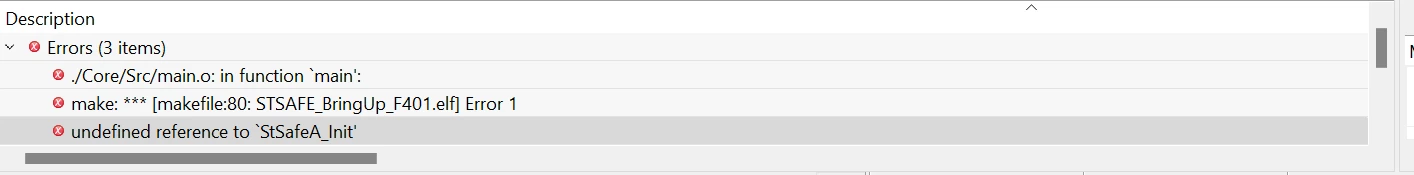

Undefined Reference To Error, but Open Declaration finds it and it's in the include path

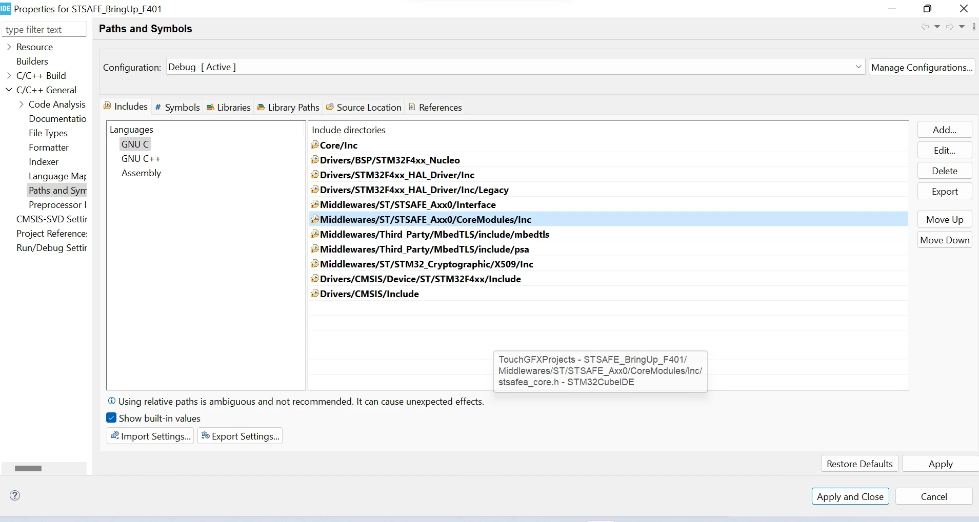

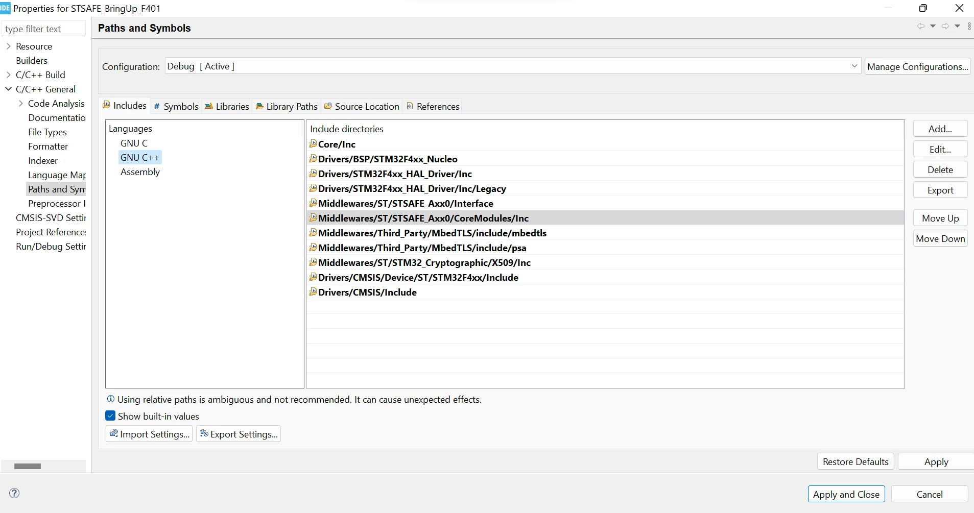

I am using the STM32CubeIDE to write software to test the STSAFE (Nucleo-F401RE + Nucleo-SAFEA1). I am trying to get a basic software working and trying to use one of the STSAFE functions, but I am running into a strange error when I try to compile it. Based on all the searches I've done, this is typically a linker issue. However, I verified that the file that declares this function.
I think I'm getting tunnel visioned, but I cannot see what part I haven't linked properly. Does anyone know where else to look?

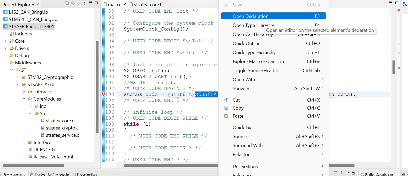

Open Declaration:

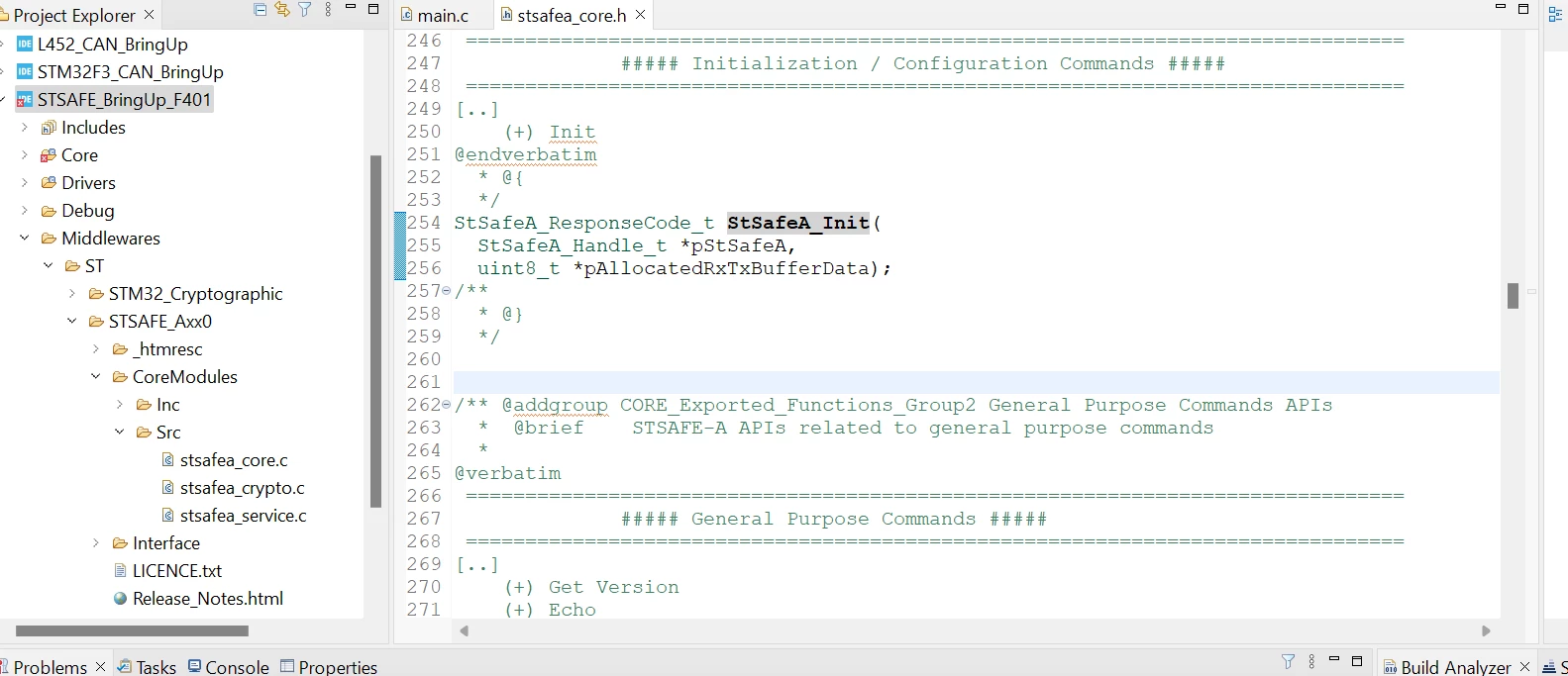

Include files define the interface expectations.
You still need the actual CODE that makes the functions work, which either comes from the linker pulling a precompiled library with that code, or the code file (.C / .CPP) for the library needs to be part of the project

Hello Tesla,
Thank you for the reply! This was exactly the problem. The previous projects I did had software packages that automatically included those, so I never looked at them before.
Doing this manually made me realize how many little linker issues there are!
