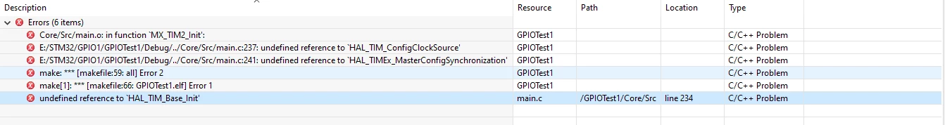

   I am using STM controller(STML031K6) first time and I have successfully run led program now I want to use timer (interrupt basis) but facing issues(undefined reference).

static void MX_TIM2_Init(void)
TIM_ClockConfigTypeDef sClockSourceConfig = {0};
TIM_MasterConfigTypeDef sMasterConfig = {0};
htim2.Instance = TIM2;
htim2.Init.Prescaler = 15999; // For 10ms interval with 16MHz clock
htim2.Init.CounterMode = TIM_COUNTERMODE_UP;
htim2.Init.Period = 999; // For 10ms interval
htim2.Init.ClockDivision = TIM_CLOCKDIVISION_DIV1;
HAL_TIM_Base_Init(&htim2);
sClockSourceConfig.ClockSource = TIM_CLOCKSOURCE_INTERNAL;
HAL_TIM_ConfigClockSource(&htim2, &sClockSourceConfig);
sMasterConfig.MasterOutputTrigger = TIM_TRGO_RESET;
sMasterConfig.MasterSlaveMode = TIM_MASTERSLAVEMODE_DISABLE;
HAL_TIMEx_MasterConfigSynchronization(&htim2, &sMasterConfig);

please help me to remove this error.

    From your code, I conclude you're using CubeMx code generator tool.
    Did you enable TIM2 from the CubeMx GUI or just you did a copy paste of TIM2 configuration from another project?
    If you copied it, I suggest you to configure TIM2 in CubeMx as it will activate the define HAL_TIM_MODULE_ENABLED in stm32l0xx_hal_conf.h to include stm32l0xx_hal_tim.h in your project.
    If you don't activate TIM in the GUI, each time you generate the code HAL_TIM_MODULE_ENABLED  will be "undefined".

    Sounds like you haven't included the HAL Timer stuff into your Project.

    Use the code pasting tool </> if dumping source code inline.
    Check you have the TIM library source included in the project build.
    That hal_stm32l0xx_conf.h calls out the TIM module for inclusion.

    #include "main.h"
    #include "stm32l0xx_hal_tim.h"
    A nice try for 1st time user ))
    But actually you need to configure a timer (or several) in Cube/Configuration view and regenerate code.
    All needed library files should be added for you.
