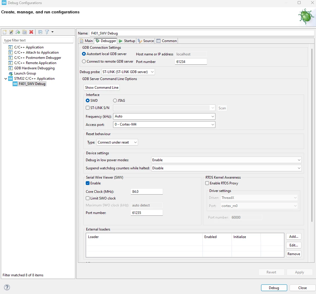

I want to use SWV Data Trace Timeline Graph but when I try to open "Configure trace" option, nothing happens, not a single window is being opened etc. Is it some kind of bug, does it have a solution? Thanks in advance.

Are you in a live debug session when you try to configure the trace or have you just switched to the debug perspective?
Have you activated SWV in the debug configuration?

I was in a live debug session, I was also observing the live expression of the same variable I was trying to plot. I activated SWV in the debug configuration but then "Configure trace" option became deactivated so I reverted it back.

Visitor II
Dec 13, 2024 1:48 AM UTC
After a lot of struggling, I figured it out that you need to hit the down arrow of debug button (bug), debug configuration, debugger and ENABLE SWV checkbox!!!!! It solved the issue for me!
