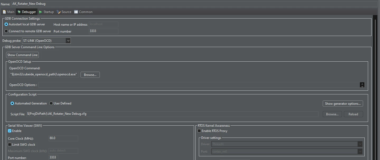

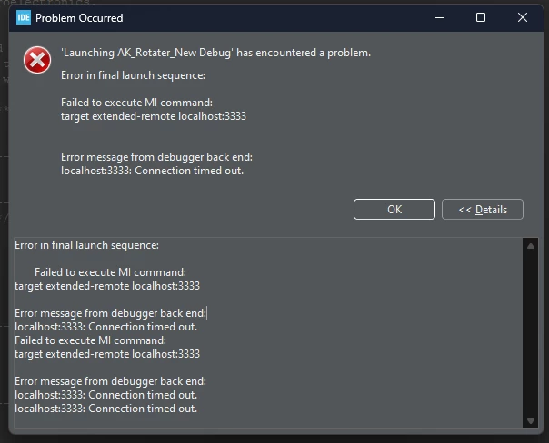

Unable to upload my code using Serial Wire Debug

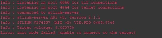

I am trying to upload my code using ST Link(SWD)into a custom board with an STM32 Core. I am using serial wire debug for programming. So I am getting the above shown error messages. If anyone have come across this issue, please help me resolve it.

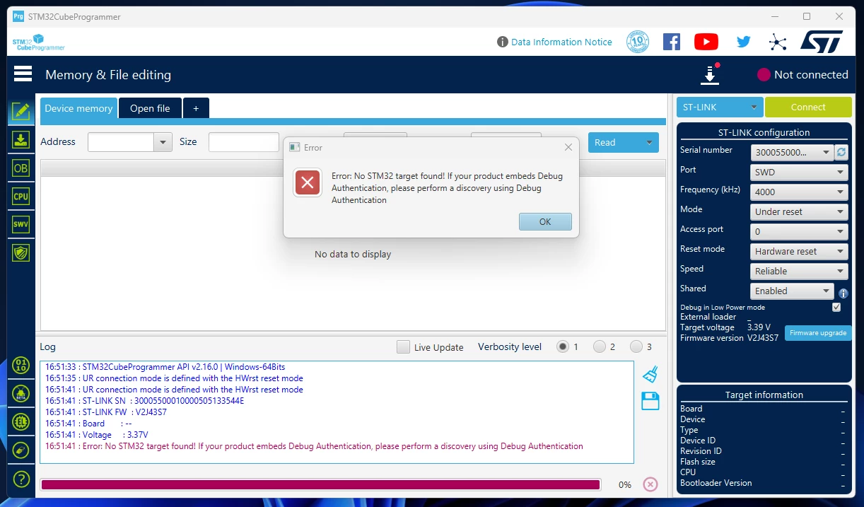

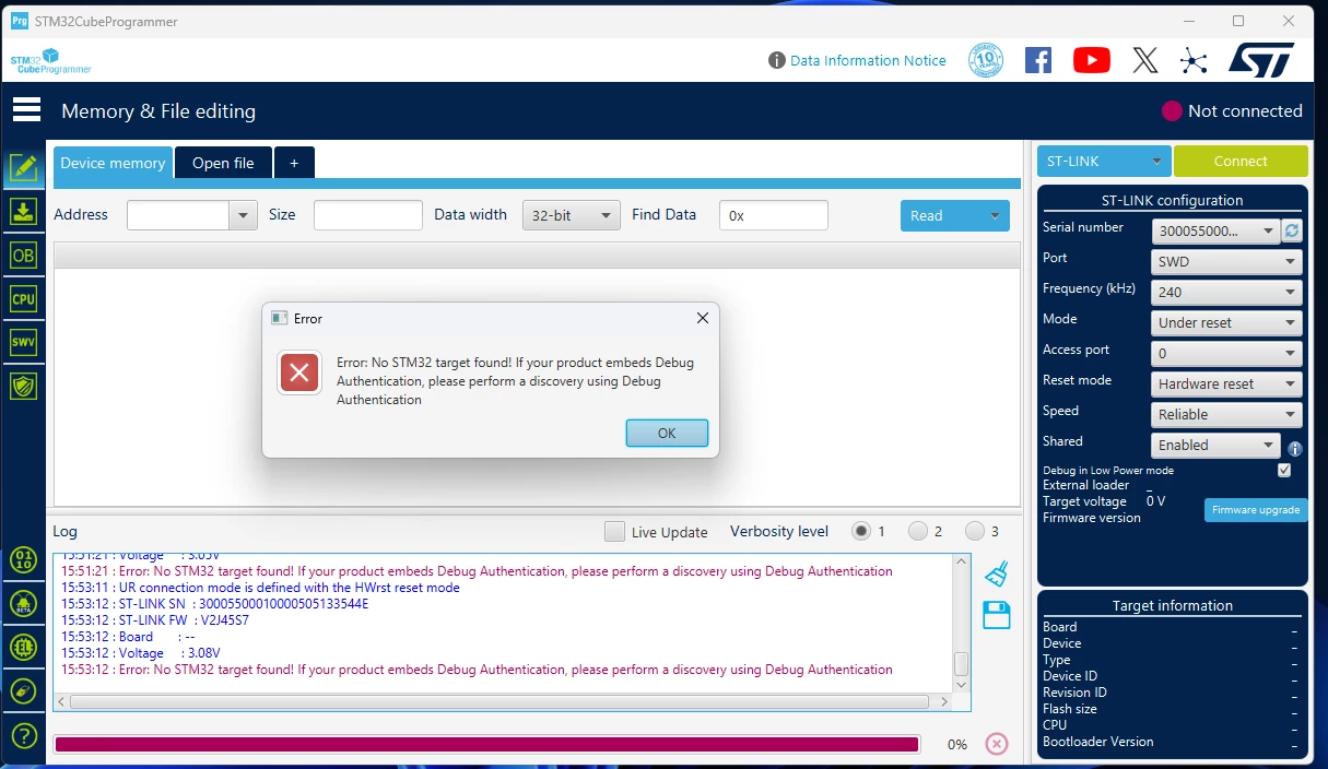

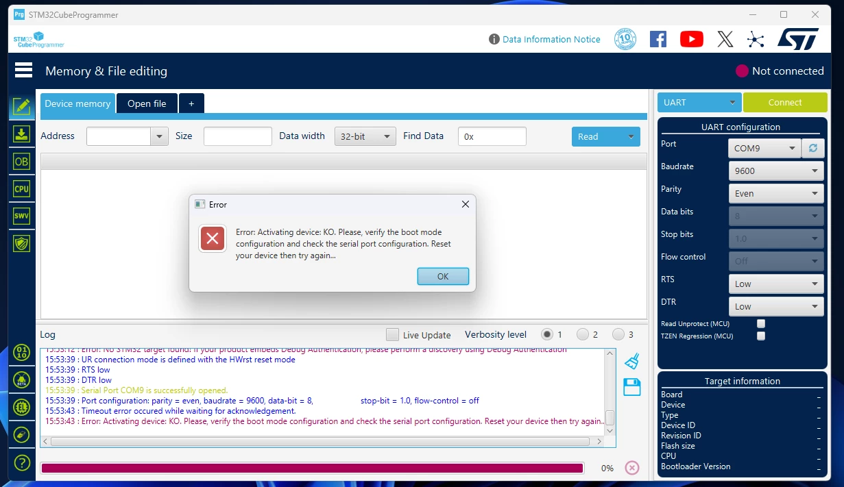

I tried uploading the code using STM Cube Programmer also. I am getting the above error.!

    Perhaps pins are not wired up correctly. Can you share a schematic? How is the board connected to the programmer specifically?
    Looks like it's detecting a voltage. That's good.

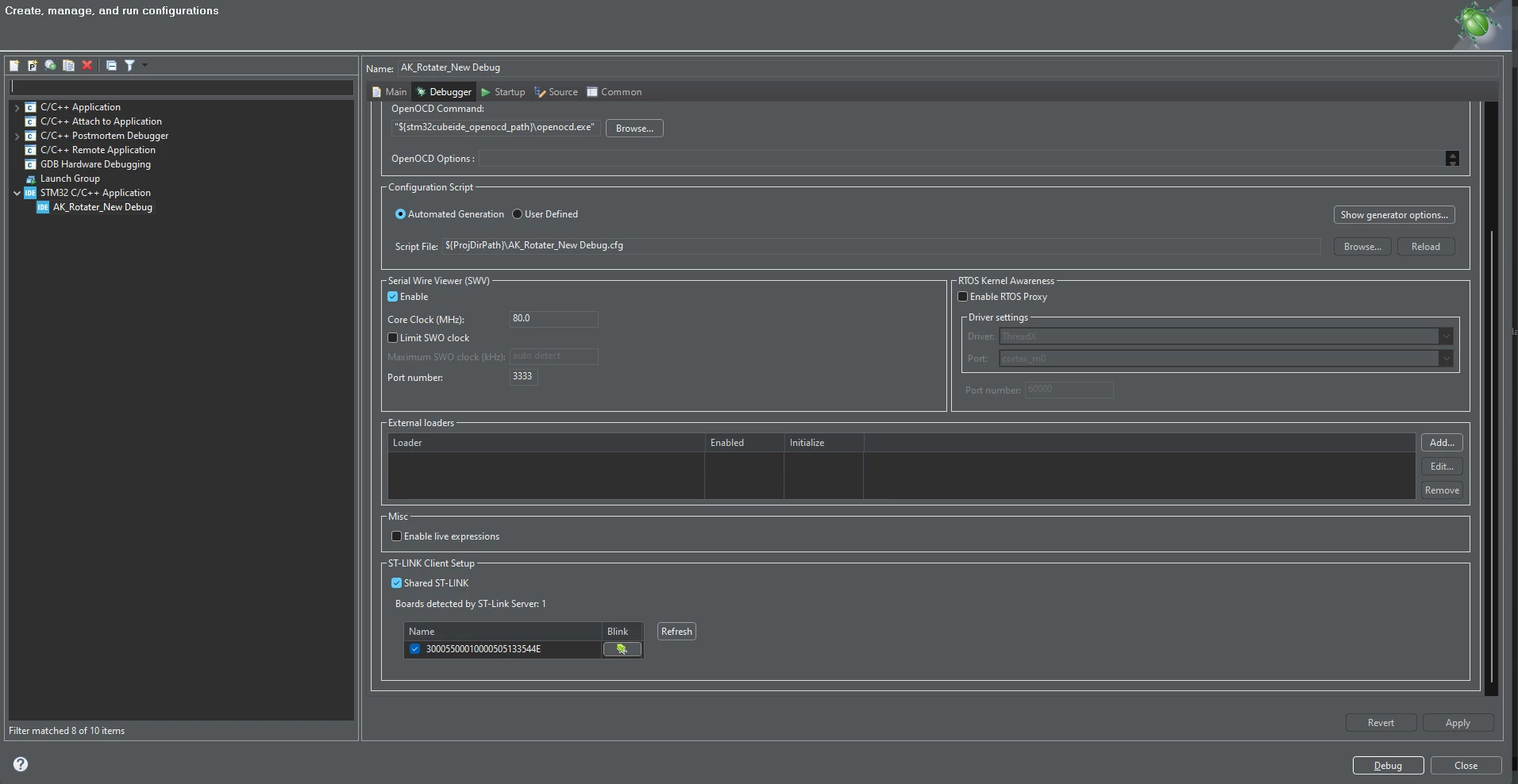

    I tried programming the custom designed board using
    i.) an external ST-LINK and also
    ii.) using the debugger IC in the evaluation board(STM32L496ZGT6).
    Both gave the same error as i mentioned in the previous posts.
    NOTE:
    I am able to program an Evaluation board without using the On-chip debugger IC by using an external ST-LINK. But not able to do the same with the custom designed board. Not able to find the underlying cause.!

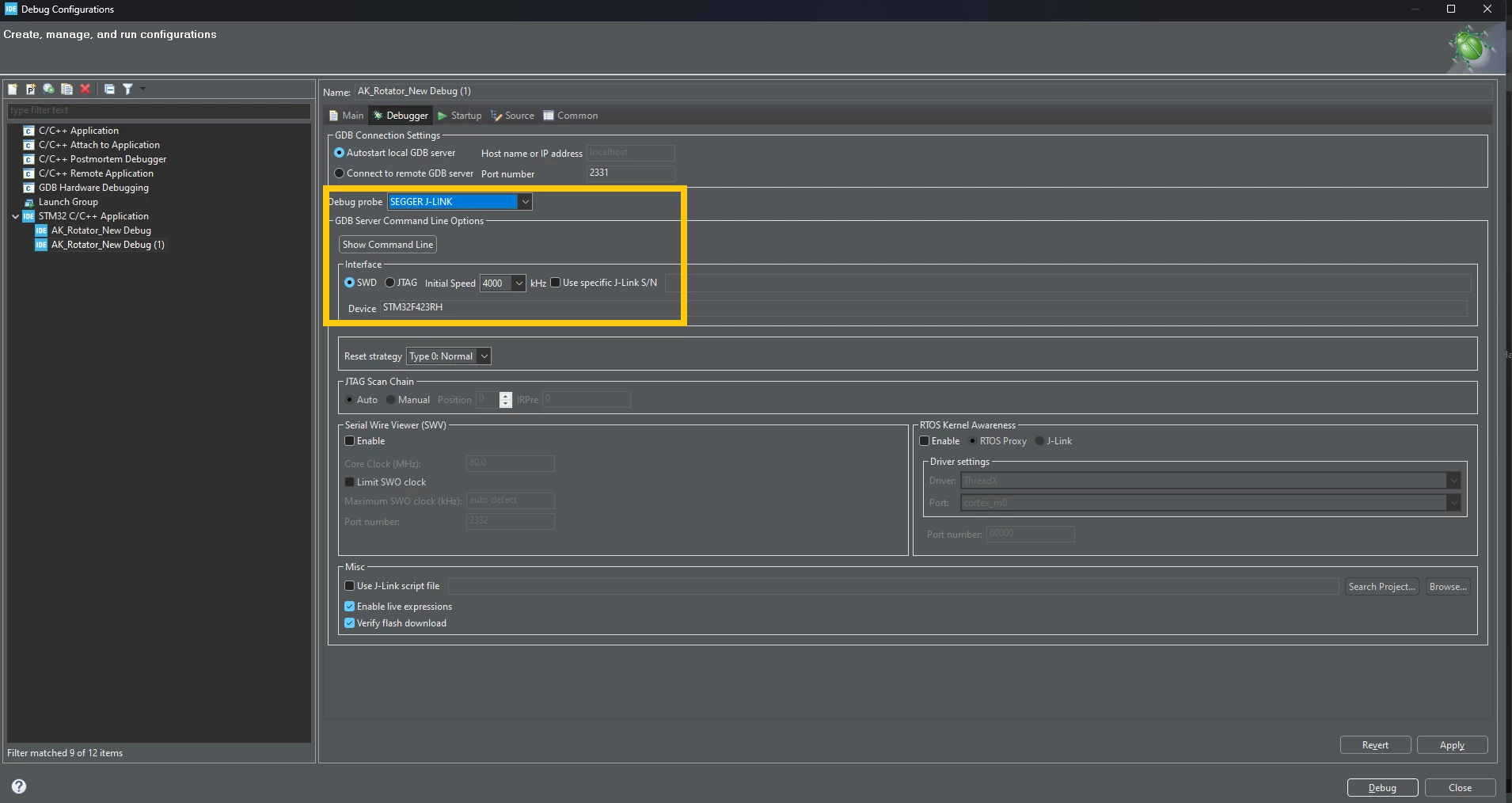

    In the debugger configuration I am able to detect the IC of the custom board. I am using Evaluation version debugger IC of STM32L496ZG to program a STM32F423RH. I am able to detect this IC when I change the setting to Segger J Link. I dont know why this happens.

    Focus on your hardware implementation,  doesn't appear viable.
    Check power, especially VDDA/VSSA
    What STM32? The make a handful of different ones, with different expectations.

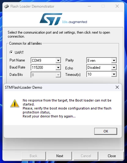

    With respect to the above link I am getting the following issues across various applications.
    I am still unable to program my custom board using the i.ST-LINK, ii.USB to UART(TTL), iii.another Evaluation board debugger IC. I don't know what the issue is. I have tried connecting the BOOT0 Pin to logic high and logic low, both. Kindly help me with the same.

    Ok, so hardware is consistently Not Working.
    Perhaps review with a colleague or other staff there.
    Answer questions posed here and ignored.
    Review schematic, symbol and net list. Check supplies and orientation. Check pin designations. Check part number. Check for fake part.

    @Tesla DeLorean  I checked with the ST-LINK, it is properly programming the Evaluation board. I don't know much about schematics and not able to find the issue in hardware side. The supply voltages I have checked with multimeter across Vcap and Vss is shorted correctly. I am struck here and not able to move further sir.!
    LCE
    Principal III
    August 8, 2024
    @vbk22398 See TDK's post above: REMOVE R2 !
    You're shorting VCAP to GND, which makes no sense at all, and might have killed the MCU.
