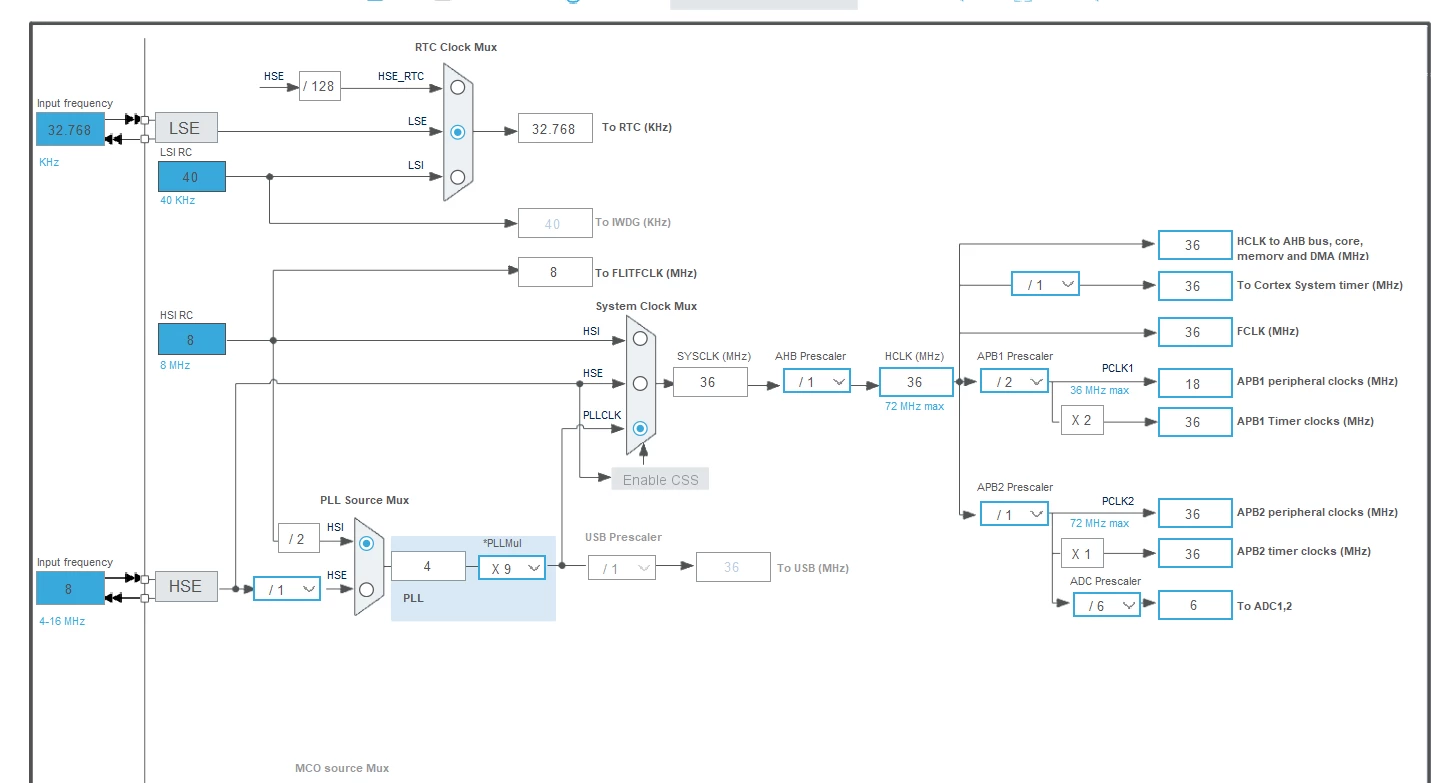

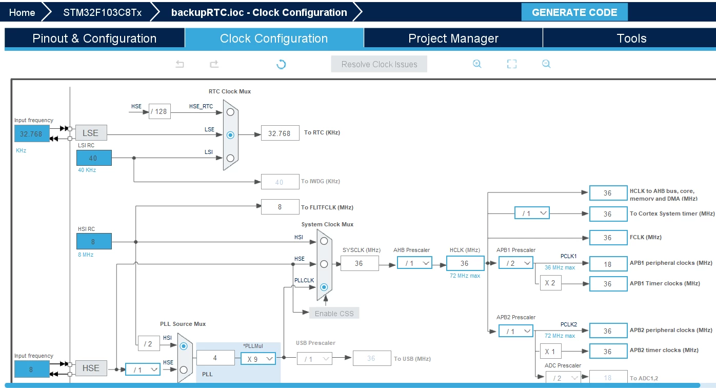

Hey buddies, I am working on STM2F103C8T6  microcontroller.  I am using LSI Clock of 40 MHz & using external clock of 36 MHz. I am trying to read the clock after power OFF & ON Low by using the following code(below) . Even though the 3.3v is detected on the VBAT pin, the clock in not getting updated during the power OFF. It is again reading from the previous stored value in the backup register. Pleas help me to resolve this issue.

    We also try with LSE but clock not getting updated please reslove the issue.you can check below clock configurationScreenshot 2024-07-30 113026.png

    waclawek.jan
    July 30, 2024
    LSI does not work if power is down.
    To maintain real time, you must use LSE.
    Ajay_9121AuthorBest answer
    July 30, 2024
    waclawek.jan
    July 30, 2024
    Does clock update during runtime?
    If no, LSE simply does not run at all.
    If yes, LSE may be marginal.
    Read AN2867 and follow recommendations.
    waclawek.jan
    July 30, 2024
    You can't judge whether LSE works or not by measuring its voltage by a multimeter.
    It's an ultralow power oscillator and unless you measure it using a specialized low capacitance probe on oscilloscope, you are likely to influence it by the measurement.
    Besides AN2867, review the many threads discussing similar problems here (including the thread you've already contributed to), and follow the recommendations therein.
