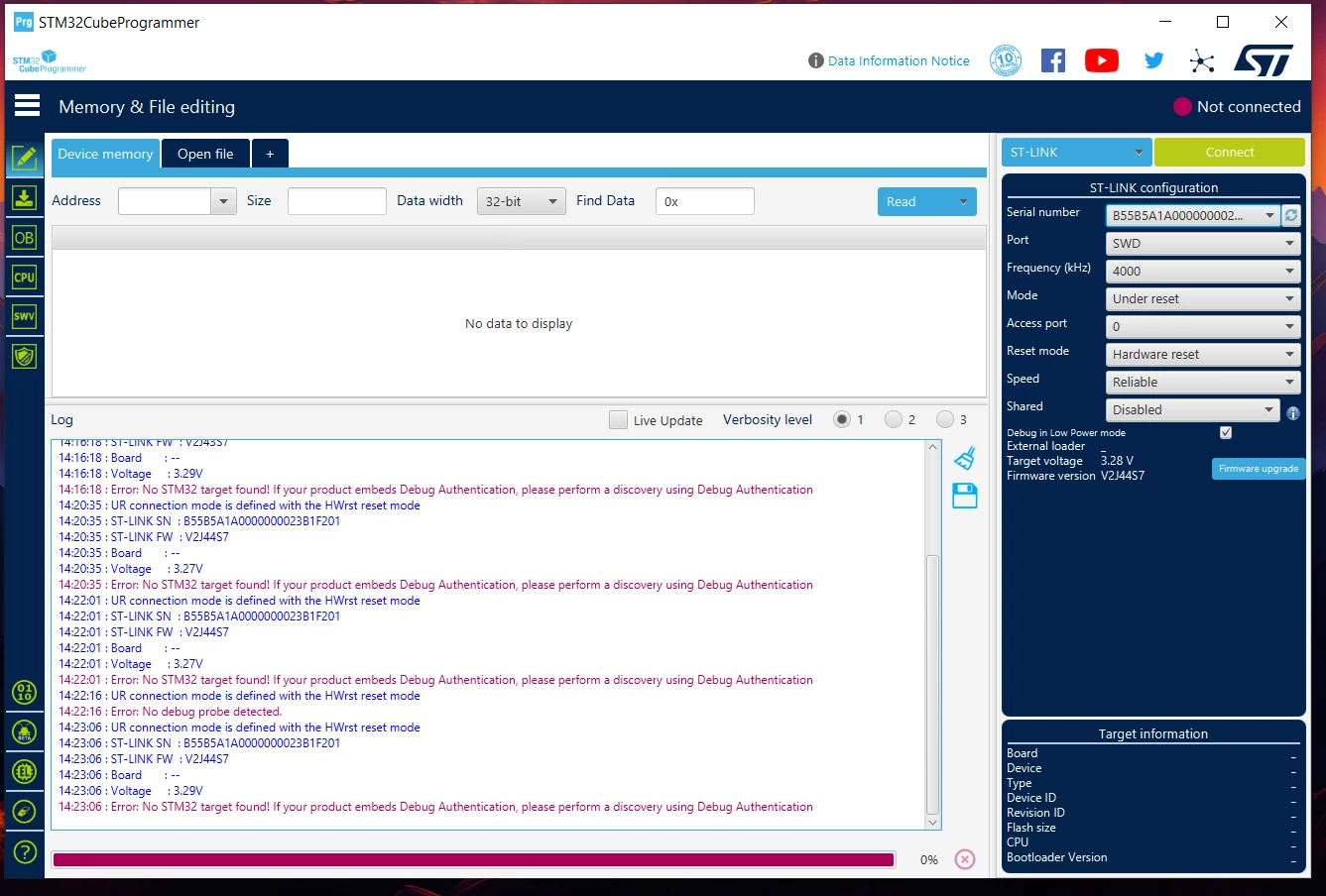

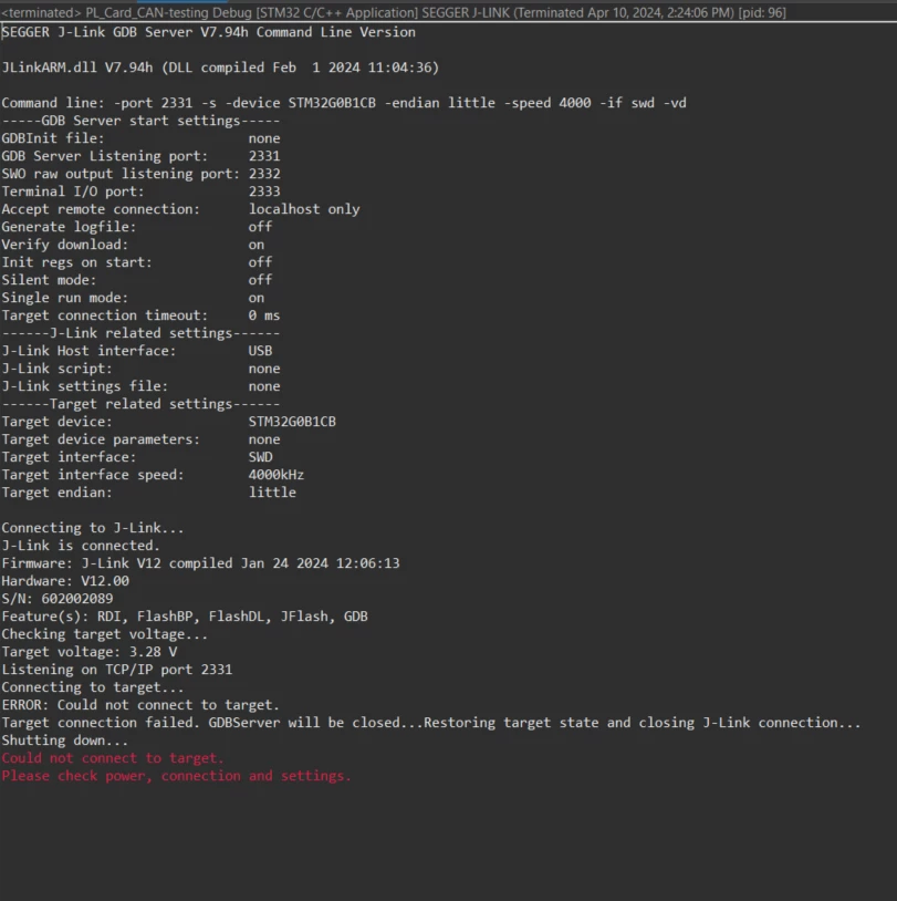

I tested PCB with BOOT_0 is Pulldown to gnd & not Pulldown to gnd & tested with both Stlink-V2 & J-Link Segger
Even In Cube Programmer also it was not detected.
The MCU In this Board is STM32G0B1CET6 & it was bought in element14, this is the first time I try to program the MCU.
I tried this for 5 PCBs all are having the same issues.

The st-link is External & I was update to latest version firmware.
The stlink & the jLink Segger is working for my other STM controller, Only this one is notworking.

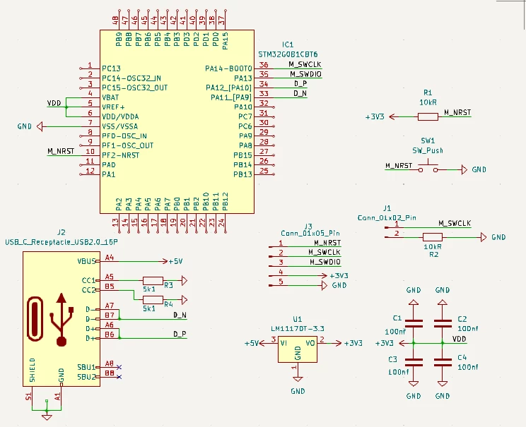

Insufficient information.
You need to provide the schematics of your custom board so community members could help you efficiently.

Suggests the board design is NOT viable. Either connecting to wrong pins or not powered properly.
Make sure VDDA is connected.
Provide salient portions of schematic.

Here is the schematic for refence in The same design I used both STM32G0B1CBT6 & STM32G0B1CET6
The STM32G0B1CBT6 is working But with STM32G0B1CET6 not working I check in STMCUBEMX Both are pin compactable just memory size is different.

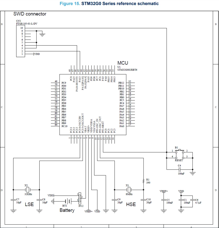

I don't see something suspecious in your schematics except the nRST pull-up resistor. No need for this resistor as there is one internal on the chip.
You can refer to the reference design provided by AN5096 / Figure 15. STM32G0 Series reference schematic:
This statement makes me having a doubt about the chip itself. It could be broken. Is there a possibility to desolder this chip and solder one you know that is working?

Solutions come from examining the situation in hand and testing, rather than me-too some anecdotes.
Failure to connect generally means the part is dead in the water for some reason, be it power, part orientation, shorts, misread documentation, incorrect/fake parts, etc.
That one type works and the other doesn't suggests more of a part issue.
Perhaps share a picture of the chip top marking, and the trace codes on the original ST packaging if available.
