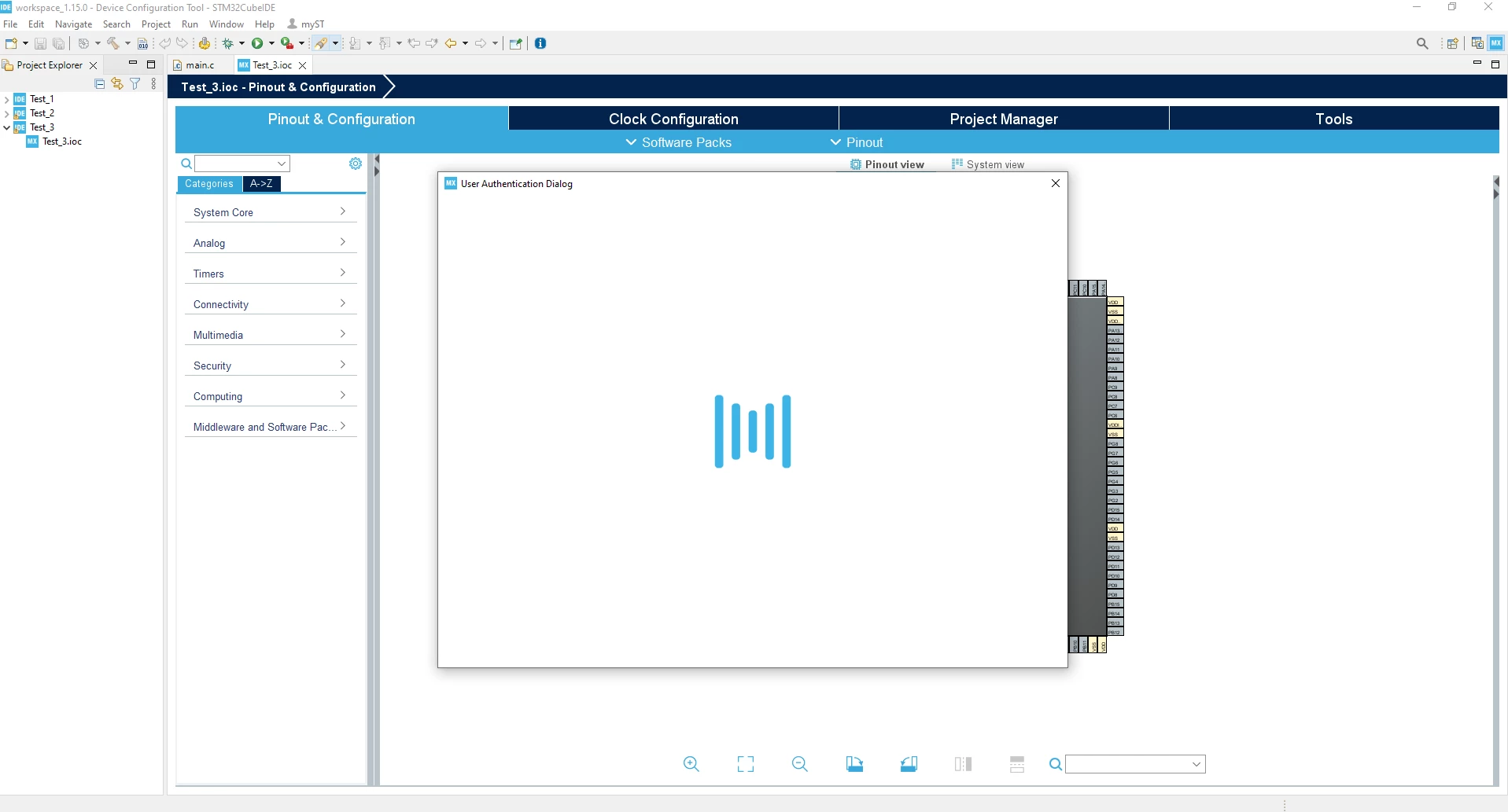

I downloaded the Version: 1.15.0 of STM32CubeIDE. It askes to login in ST for new project to download all the package. When I clicked on the myst -> login, "User Authentication Dialog" opens and nothing happens after that.
Thus I am unable to login.

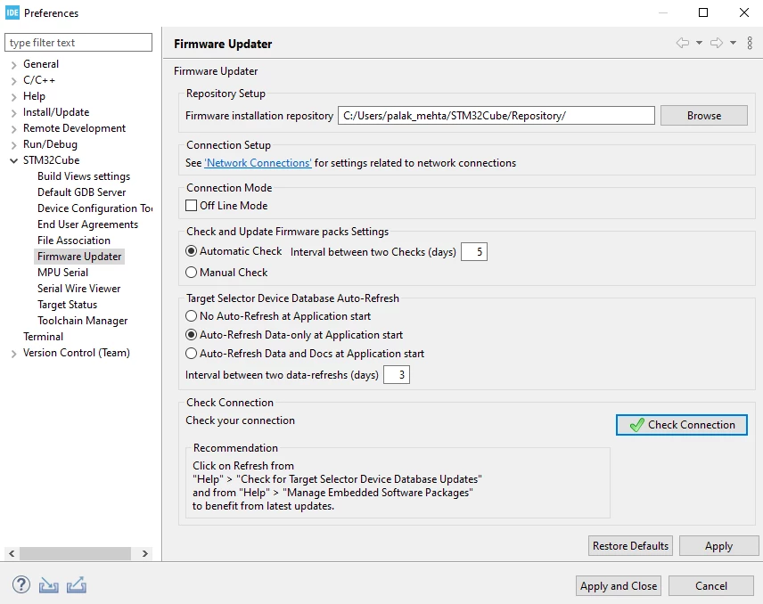

I checked the connection.

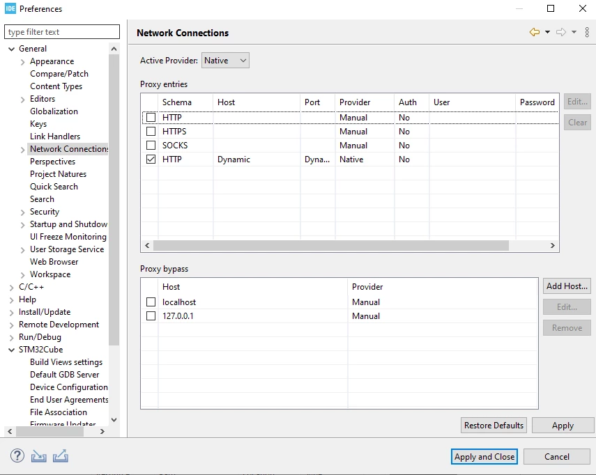

Hi Nick,
When I used my home WIFI, I was able to login. On my company's network, software was not able to find the correct proxy, my IT fixed it and now it works on my company's network as well.

Hi Tajim743Z,
Please let your IT department check the proxy settings on their side. Our IT department didn't mention in detail but just let me know they enabled the proxy port for STM32CubeIDE to access.
