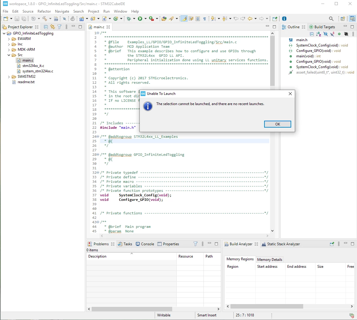

Using this tutorial I went to run GPIO_InfiniteLedToggling as my first example using STM32CubeIDE, but at stage 5 of that tut when it wants us to debug the project (F11), I get that Unable to Launch error:
How to fix this issue, please?

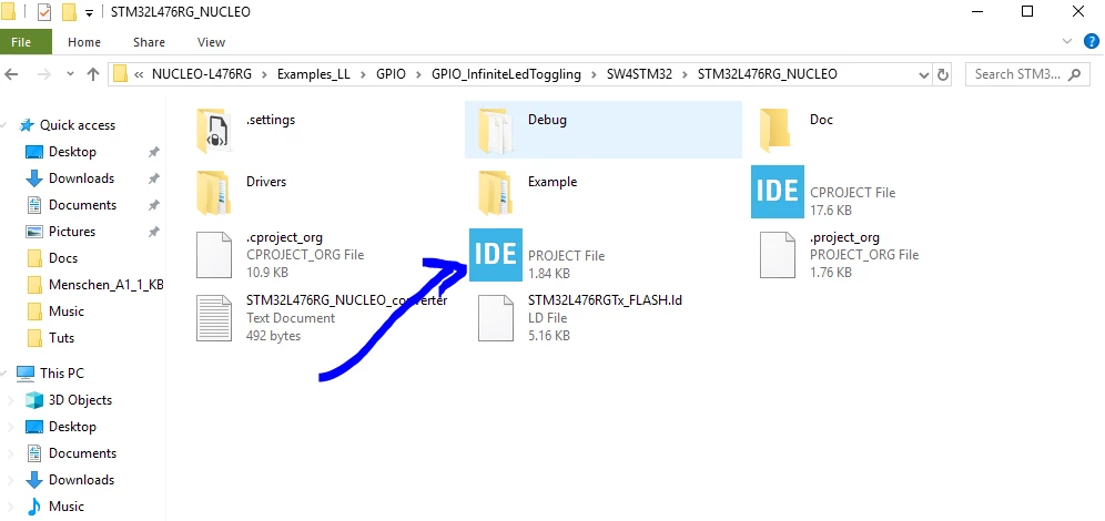

Loops like you may have imported it incorrectly.
If you open the .project file within the SW4STM32 folder and let STM32CubeIDE import the project, it should work.
January 9, 2022

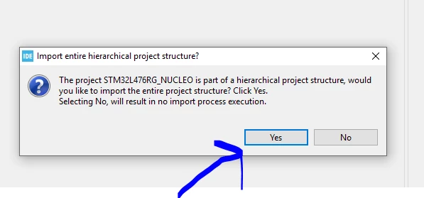

Do you mean the .project file in the following address?0693W00000Hr1h0QAB.pngAfter opening it with the IDE, this message appeared:
0693W00000Hr1hjQAB.pngI clicked Yes.
The another message:
0693W00000Hr1htQAB.pngAnd finally press F11 to debug.

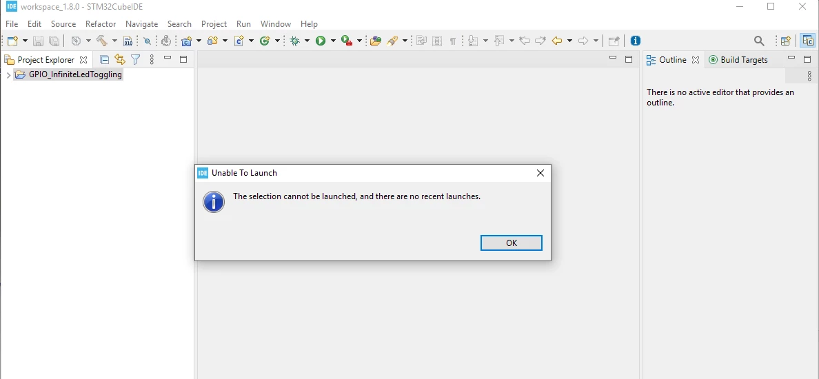

0693W00000Hr1i3QAB.pngAbd as you can see, no change in the result!
Why do I get that message? :(

That is the file I meant.
I double clicked on that file to open it and ran through these steps myself and had no issues opening the project and debugging.
Note that your cursor needs to be within a project file when you hit debug in order for it to know you want to debug that project.

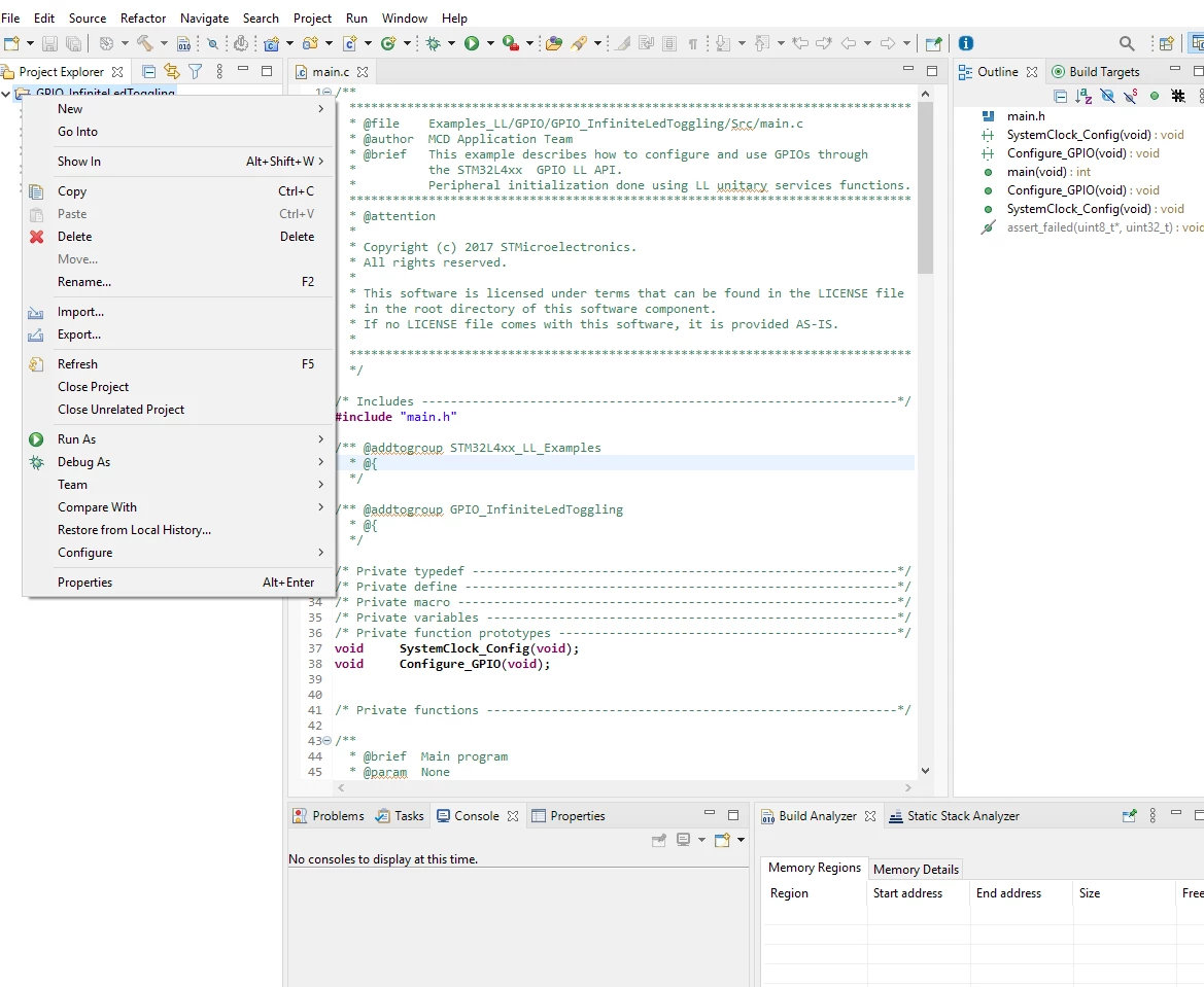

At what address on you machine did you find and run your .project file, please? There're a couple ones I tested but all had the same issue!
I guess there must be a problem with the project, or the IDE doesn't recognize it as a complete project. I tried to attach my STM32F411RE board to the PC but this didn't give any success.
By the way there's no Build option on the pop-up menu when right-clicking the project name:
January 11, 2022
I actually found the issue just by messing with the files, say, the .project file! That file exists in a little further directory in the address shown in the tutorial. That is, we need to go further to ...\GPIO_InfiniteLedToggling\SW4STM32\STM32F411-Nucleo on the Import Source. That way the project debugs, and runs successfully on the board as expected.
