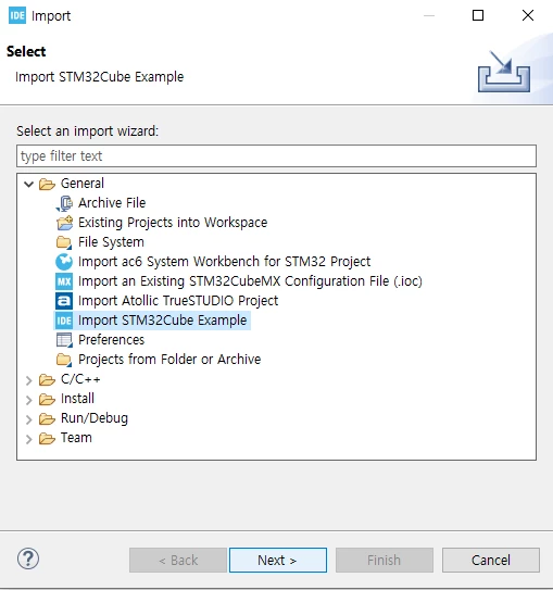

At the moment I found an alternate way
File -> Import ->  Following window shows up
Import ExampleImport Example
Expand General -> Select Import  STM32Cube Example -> Next

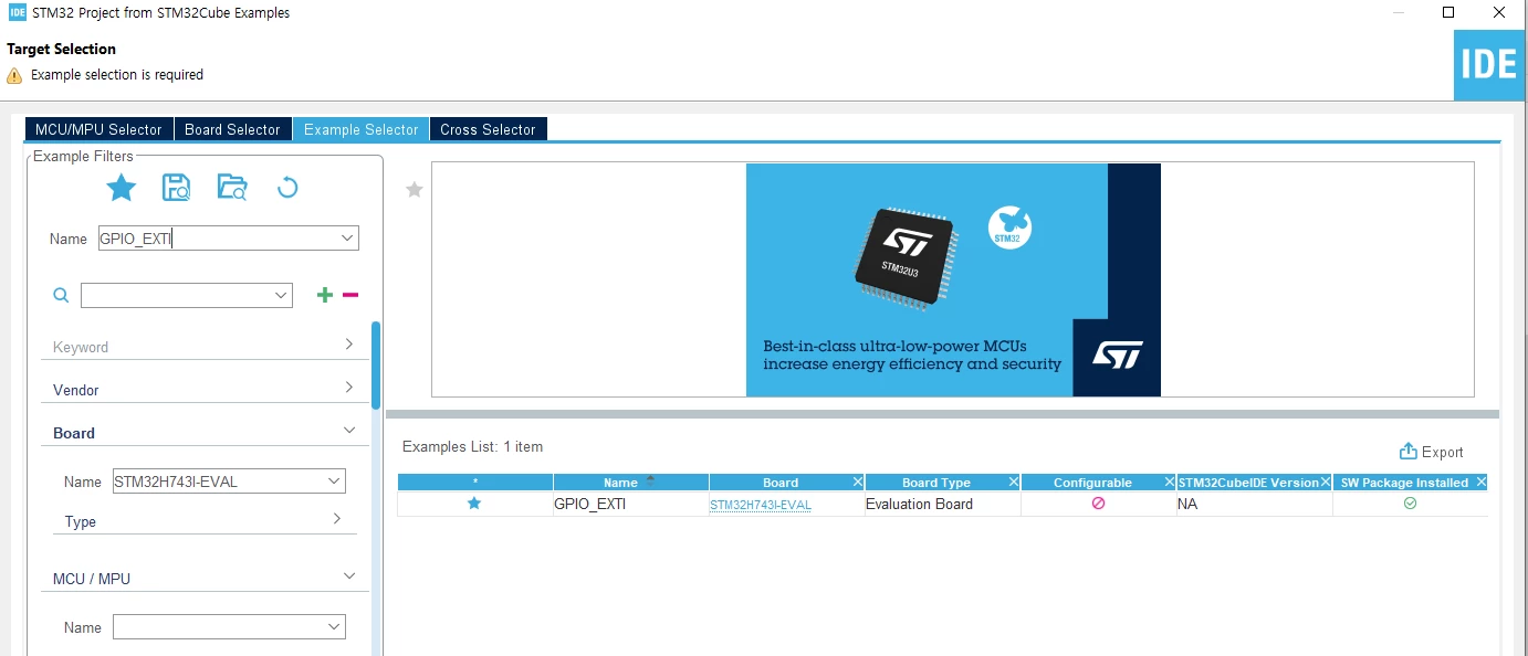

Target Selection window will showup
first select Board and then Example Name
