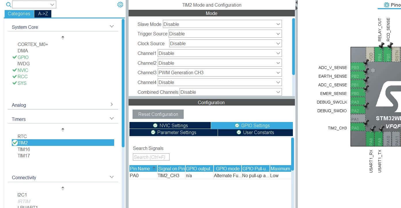

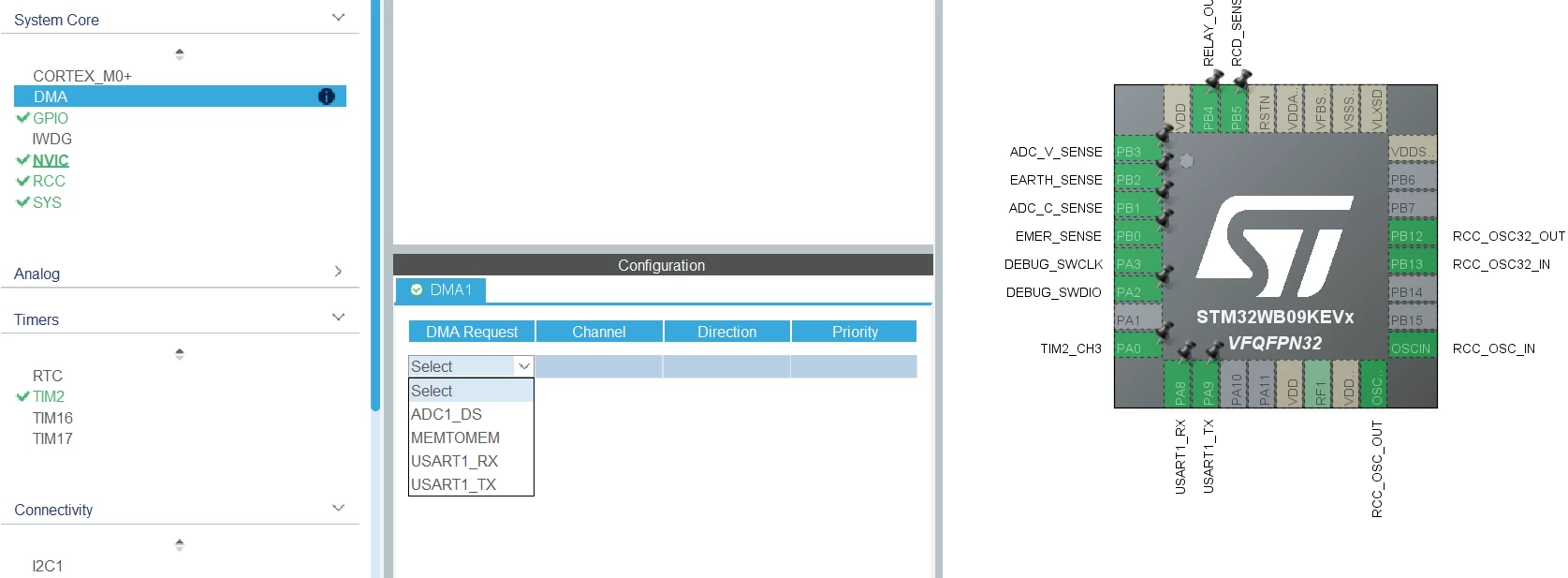

I'm trying to configure DMA in Memory-to-Peripheral mode for the STM32WB09KE, specifically to transfer data from memory to a Timer channel (TIM2_CH3 for Addressable LED's). However, in STM32CubeMX, I cannot see the expected DMA options under the DMA Settings tab for my Timer.

This issue has been fixed in the latest version of STM32CubeMX 6.18.0
Download STM32CubeMX6.18.0 from  here

Issue has been escalated to dev team under internal ticket ID 226309 for resolution.
