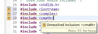

Unable to include c++ libraries in STM32CubeIDE
Hi
I am trying to include the standard C++ libraries in my STM32CubeIDE code, however I am getting an "Unresolved inclusion" Error.
This project is configured as a C++ program, as the project drop down menu only allows me to convert this project to a C program - which implies that the current project is configured as a C++ project. e.g.
Is anyone familiar with this issue and know how to resolve this ?
a swift reply is much appreciated :)
Thanks

Dec 28, 2020 3:33 PM UTC
Is the filename you're editing a C (*.c) or C++ (*.cpp) file? Needs to be *.cpp to include C++ headers.
PPoob.1
PPoob.1Author
Dec 29, 2020 5:05 AM UTC
it is a .c file , any ideas on how to convert this file to a .cpp ? Or am is my only option to create a new cpp project, and copy over the code. Thanks
TDKBest answer
Dec 29, 2020 5:20 AM UTC
Rename the file.
