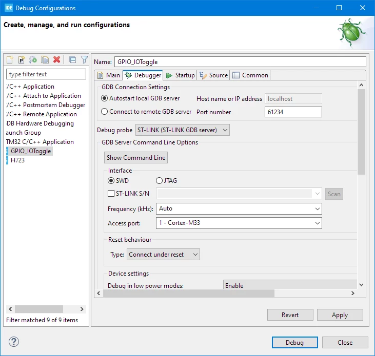

Mike_ST
December 11, 2023
Hello Nikita,
I'm not sure this is your problem, but the STM32H5 needs to communicate via Access Port 1, make sure this is correct in the Run/Debug settings.
It is a common misconfiguration when using H5.
The STM32CubeProgrammer switches automatically to Access Port 1, but I'm not sure for STM32CubeIDE.
For the H723 board, I have no clue.
Nikita91
Nikita91Author
Lead II
December 11, 2023
Yes the IDE selected the access port 1:H563_debug.png
It's the only choice.
