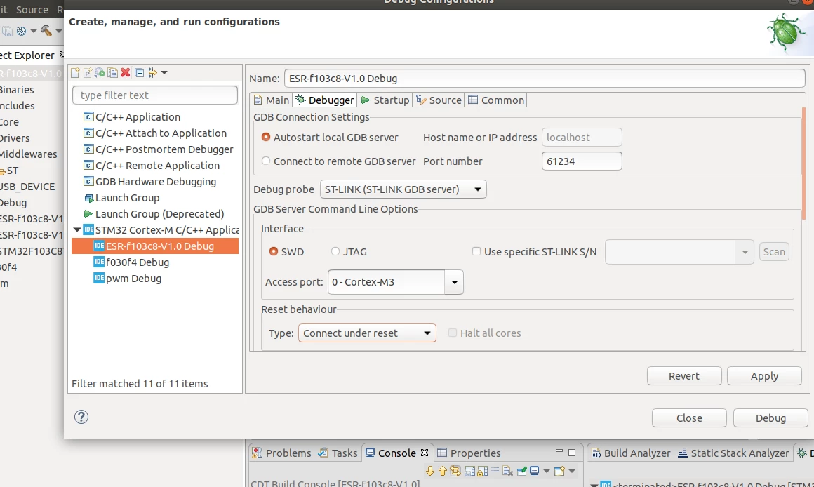

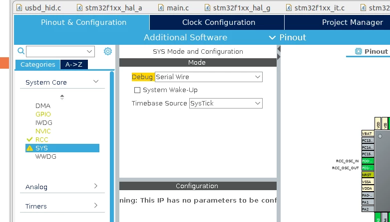

Using cubemx? Check the debug option in cubemx -> swd. Then regenerate project. And in IDE chceck flash under reset.​

Thanks very much for your response! I am using STM32CubeIDE (1.0.2). I'm struggling to find the options you suggest. I've looked in the 'Project Manager' of CUBEMX (by loading the .ioc), but I can't find SWD mentioned anywhere. Also, I can't see where to look for 'flash' in the IDE. I've looked in all the tabs under 'Project->Properties. If you could give me some more pointers on where to look, I'd really appreciate it. Thanks again!

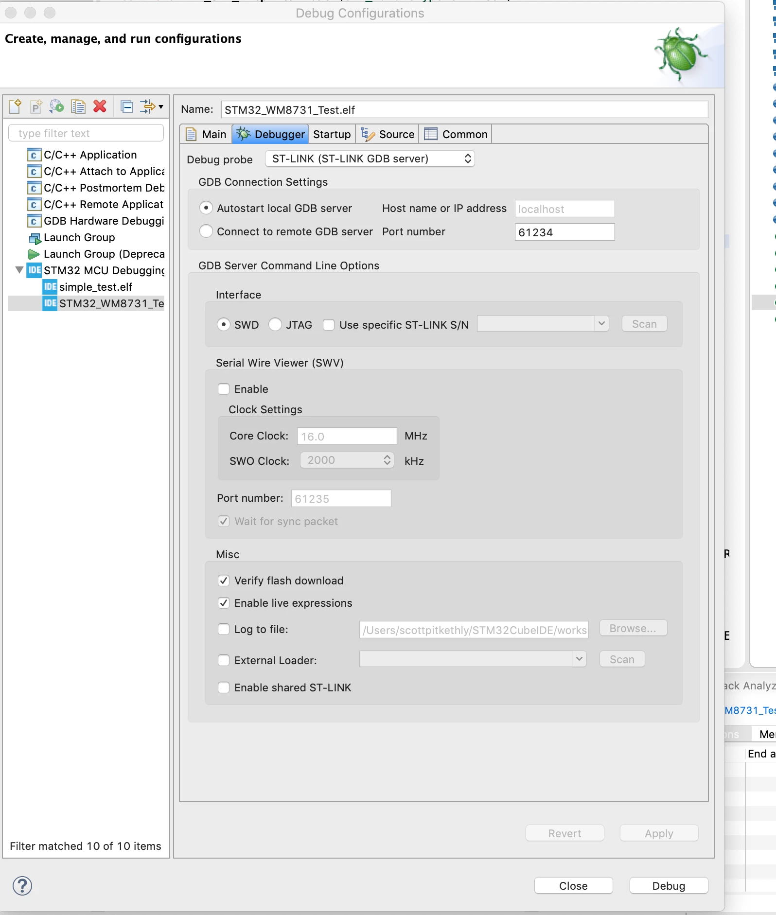

0690X00000BvSU7QAN.pngThanks for doing that! As far as I can tell I have this setup correctly, and it appears to match one of my working projects. The config in the .ioc looks the same as yours, but my 'Create, manage, and run configurations' looks a bit different, screenshot attached

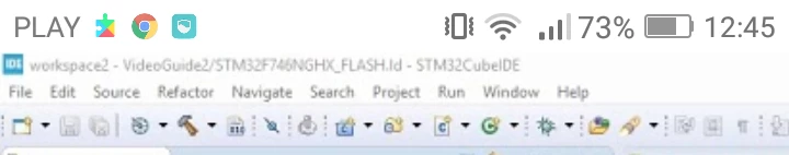

Look in global settings. When you clikc run-debug as-stm32​ ... in run- schould be "configure" or "debug configure".
Cubeide at top of window.​
