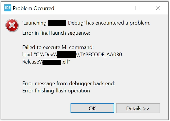

I am having a problem where I am unable to run my code in debug mode from within STM32CubeIDE v1.15.
I can program the device fine with STM32CubeProgrammer, but when I try to debug I get this output:
log output file: C:\Users\[me]\AppData\Local\Temp\STM32CubeProgrammer_a23280.log
ST-LINK SN : 004C002F3532510F31333430
ST-LINK FW : V3J14M5B5S1
Board : STLINK-V3SET
Voltage : 3.26V
Error: ST-LINK error (DEV_UNKNOWN_MCU_TARGET)
2nd connect tentative with frequency (8MHz)
Voltage : 3.26V
Encountered Error when opening C:\ST\STM32CubeIDE_1.15.0\STM32CubeIDE\plugins\com.st.stm32cube.ide.mcu.externaltools.cubeprogrammer.win32_2.1.200.202311302303\tools\bin\STM32_Programmer_CLI.exe
Error in STM32CubeProgrammer
Shutting down...

    Further info, I also get this dialog when the debug fails:

    What microcontroller, and on what board?
    Are you using 'Connect Under Reset' ?
    The "ST-LINK error (DEV_UNKNOWN_MCU_TARGET)" would seem to be key:
