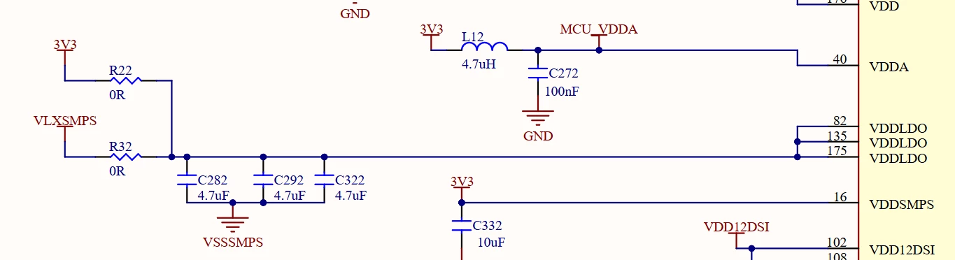

I am using my custom PCB with the STM32H747IIT6 microcontroller. I have set up a JTAG/SWD connection. Initially, when I power up the board and connect via ST-Link, I can access the microcontroller through STM32CubeProgrammer without any issues.
However, after generating a new code in CubeIDE and flashing it onto the MCU, I can no longer connect to the device. I have tried selecting all available connection modes in CubeProgrammer, but none of them work.
"Error: No STM32 target found! If your product embeds Debug Authentication, please perform a discovery using Debug Authentication."

The only way to regain access is by setting the BOOT0 pin HIGH, performing a Full Chip Erase, and then pulling BOOT0 back to LOW. After this process, I can connect again, but as soon as I flash new firmware, the same issue occurs.
I have attached images of my configuration settings and schematics.
How can I resolve this issue? I have tried both Serial Wire and JTAG modes, but the problem persists.

Maybe i assemblied R32 before. I removed it and assembled to the R22. It is working now. I don't now maybe main reason it is.

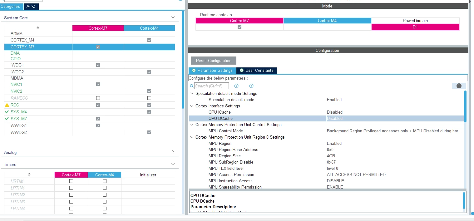

I activated cortex_m7 modes. It is working but I don't know how to adjust the settings here. What should I set this settings? I have no information about this part.
Why do you want to adjust things? There is no "correct" setting. They are there to allow customization based on your needs. If you have no idea, leave them alone at default.
If you want to know more about a particular item, the reference manual is a good place to start. A bit out of scope to explain everything here especially as it's not the issue related to being unable to connect.

Since the issue is happening after flashing a code into your MCU, i would suggest you to check the power configuration.
You should check the power circuit you have put in your desing/pcb/schematic and ensure that is the one you are telling to the mcu on RCC configuration.
Hope it helps.
