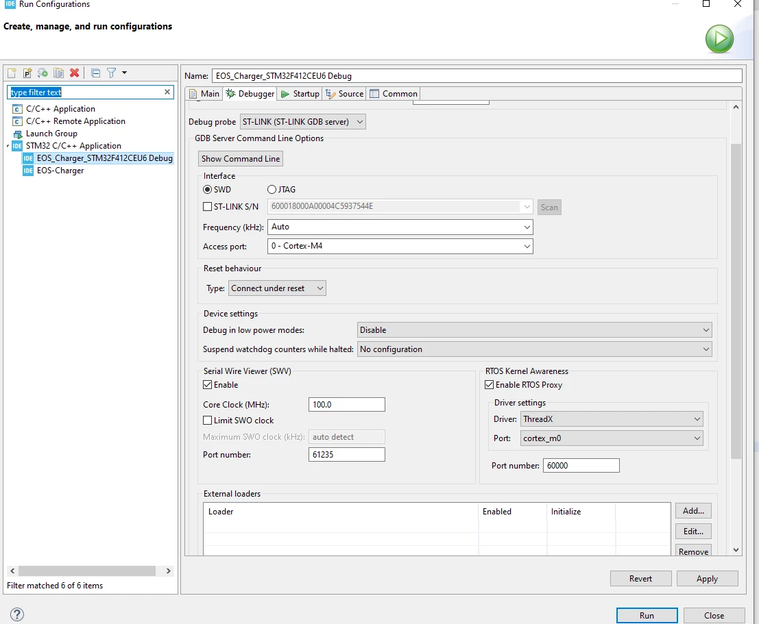

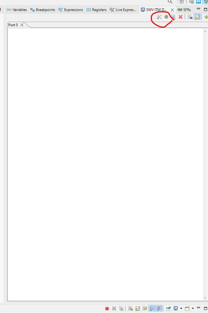

Unable to configure Serial Wire Viewer
Does anybody have an idea why the settings button is grayed out?
MCU: STM32F412
Other settings seem fine to me:
6 replies

Aug 17, 2023 12:06 PM UTC
you are in active debug session ?
SWV settings only active then.

Yes, I press debug and the debug perspective opens.
tarmogrAuthor
Aug 18, 2023 8:22 AM UTC
NVM. got it working

Hello @tarmogr ,
Which CubeIDE version is used?
Try to increase the stack size/trace buffer size (window > Preferences > STM32Cube >Serial Wire Viewer).
