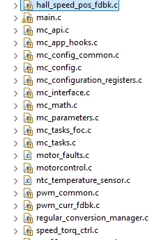

I am unable to change the project name in STM32CubeIde, if i change it
and try to open it i get error windows cannot find the file. They are all linked files, may be that is causing the issue, what changes i have to do avoid this error. The project is generated using MCSDK and after generation i am trying to change the project name in CubeIde.
