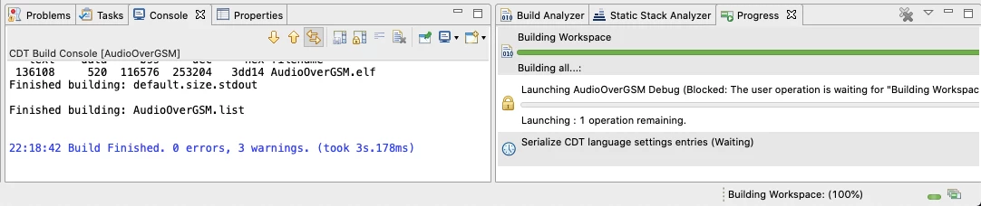

Unable to build or debug (versions above 1.4.0) in MacOS Mojave.
When i try to build a previously working project, the build process just sort of hangs. If it does complete, it won't let me debug.
The error code for debug is related to ST link server. I have ensured that ST Link server is properly installed.

Then i gave my laptop a sleep cycle (Closed lid - opened after a while) and it stopped building again. It won't even let me stop the build process. Just stuck at 'Building workspace 100%'. I have to force quit the application.
Another interesting observation is that after i re-launched the IDE and opened the project, the default status is 'Building workspace 100%'. and its just stuck.

AkshayPatwardhan
September 18, 2020
0693W000004GTRTQA4.pngThe build is finished but the bottom right corner still says building workspace 100%.
Here's an image for reference.
When i try to close the IDE, this happens:
Attaching the .log file as well.
