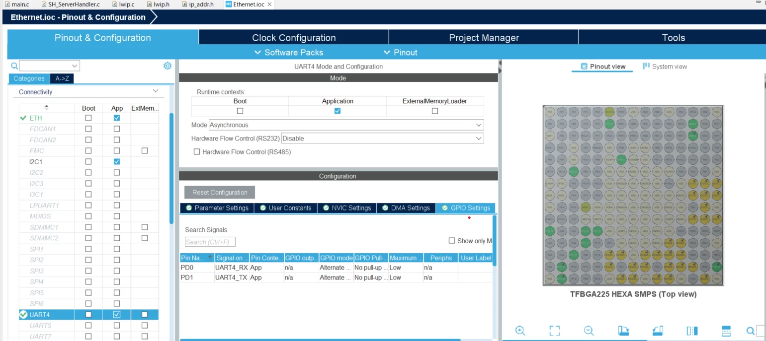

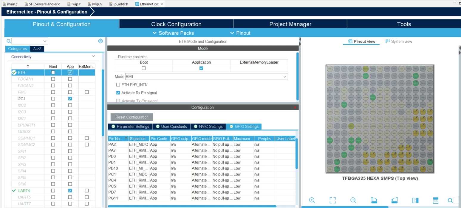

Hi @Pavel A. ,
No there is no pin conflict between ETH and UART4.
Here I attached screenshots of both configuration.
Please look at this also,
I am encountering errors when I enable Ethernet and UART4.
Could you help me troubleshoot and resolve this issue.
