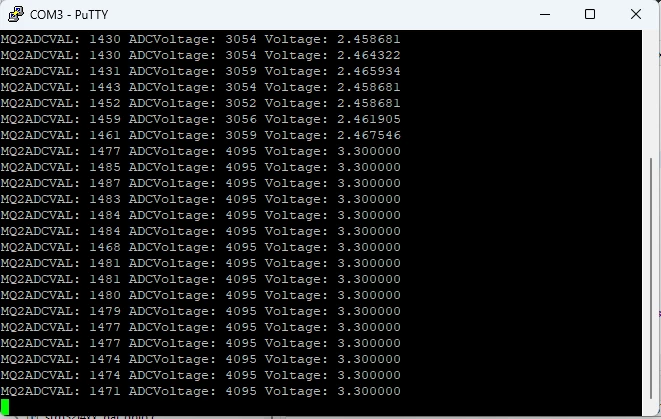

UART Output slow with DMA
I recently wrote some code with the help of stack exchange regarding an MQ2 gas sensor. I needed to alter the code to use DMA as the MCU I'm using for the project only has one ADC channel. My goal was to measure the ADC value of the MQ2 sensor along with a battery voltage for when it drops below 2.5 volts to blink a red LED. I'm noticing that the UART is very slow when outputting numbers, and when I adjust my voltage source voltage it takes a few seconds to update. It only seems faster when the Battery voltage isn't below 2.5V.
I'm not sure exactly what I need to fix with my code but it can be seen below:

PuTTy terminal:

    waclawek.jan
    Jul 2, 2024 6:12 AM UTC
    You don't show things like how do you calculate the result, but besides that, it is full of delays and blocking code. For example, isn't this a deliberate delay?
    if(Voltage<2.5){
     HAL_GPIO_WritePin(GPIOC,BATLED,GPIO_PIN_SET);
     HAL_Delay(500);
     LED,GPIO_PIN_RESET);
     HAL_Delay(500);

    waclawek.jan
    waclawek.janBest answer
    Jul 2, 2024 12:16 PM UTC
    Which STM32 are you using?
    > Should I control the LED via a Timer channel?
    Maybe; but generally, you want to understand design methods for non-blocking operations(*).
    > "You don't show things like how do you calculate the result" - I'm a little confused what you mean by this can you further clarify?
    In the original post I overlooked this:
    Voltage = (ADCVoltage *3.3) /(4095);
    This (and also the comparison of Voltage to 2.5) is a double-precision calculation (*), and as such, it takes relatively long time even on a STM32 which has a single-precision FPU like the 'F4 family. You want to use single-precision float constants and explicit casts:
    Voltage = ((float)ADCVoltage *3.3f) /(4095.0f);
    (*) These are relatively basic elements of microcontroller programming (although the double/float etc. is C programming in general), and this is not the proper place to explain them. You may want to do extensive reading and/or take some appropriate courses.
